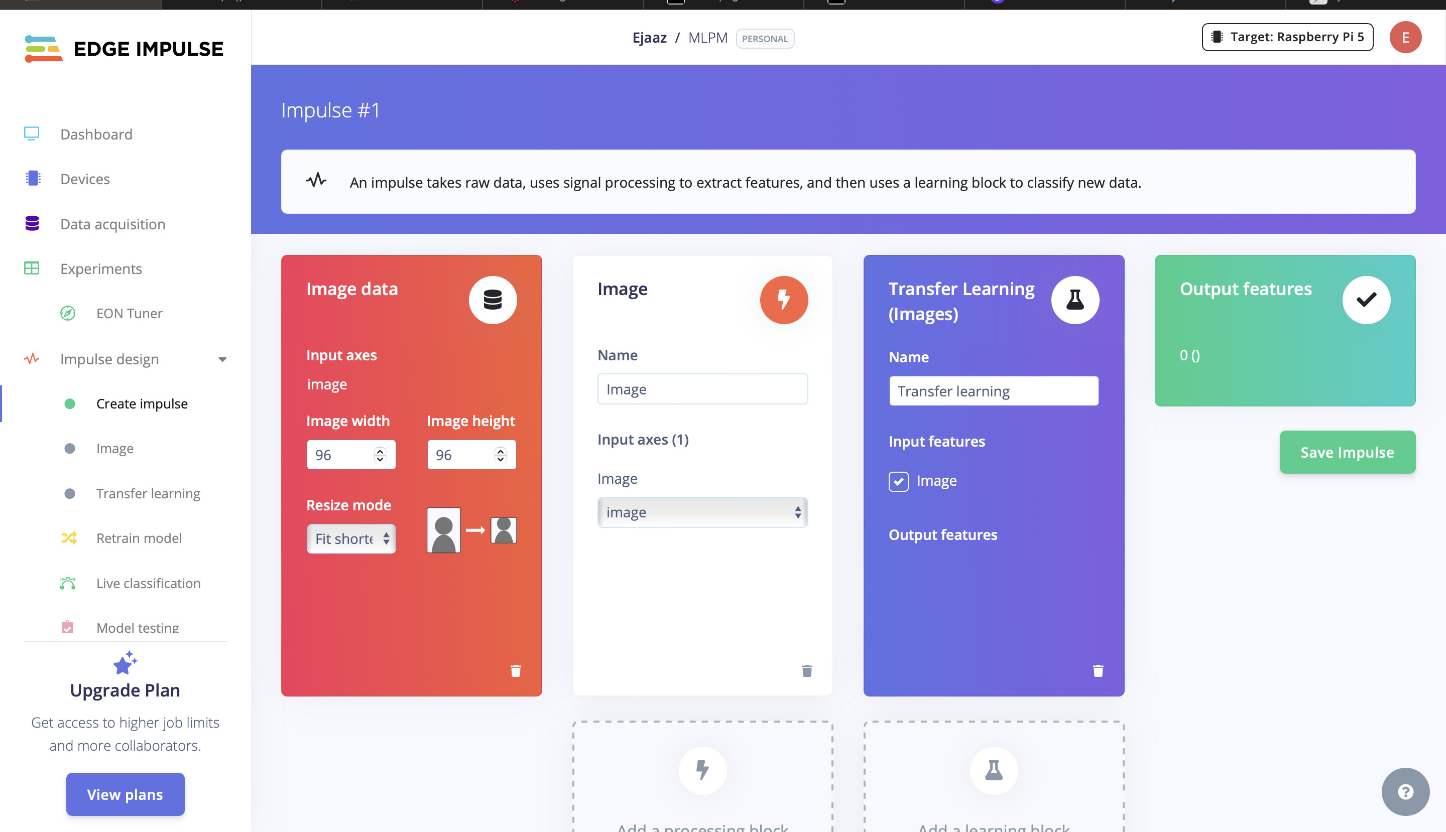

I am trying to connect an IMX219 camera to a Raspberry Pi 5 to deploy a computer-vision model from Edge Impulse (Project ID 794931 – MLPM).
The camera works perfectly with the Raspberry Pi camera stack (rpicam-hello -t 0 runs fine), but when I run:
edge-impulse-linux
it fails with the message:
“Cannot find any webcams, run this command with –disable-camera to skip selection.”
I’ve verified that the camera hardware, ribbon, and detection under libcamera are all functional, but Edge Impulse doesn’t recognize it—even though the official documentation lists Raspberry Pi 4 & 5 as supported.
794931
I previously had this same Edge Impulse project running successfully on a Raspberry Pi 4 with the same IMX219 camera.
However, after transporting the setup, the camera stopped appearing, and raspi-config no longer displayed a “Camera” option.
I then switched to a Raspberry Pi 5 with a fresh install of Raspberry Pi OS Bookworm (64-bit), but encountered an issue—the camera works fine with rpicam-hello, yet Edge Impulse cannot detect it.
I thought the problem might be related to Edge Impulse not yet supporting the new libcamera-based stack that replaced the older V4L2 interface on Pi 4/5 systems.
