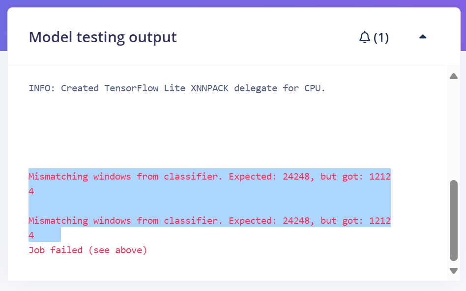

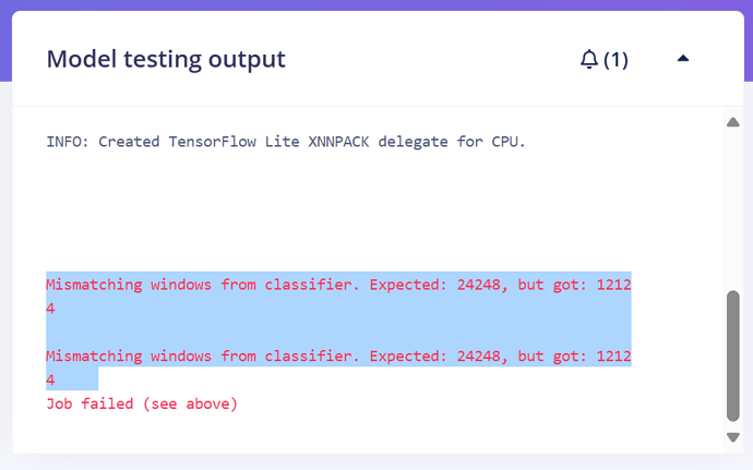

Mismatching windows from classifier. Expected: 24248, but got: 12124
708193
Running Model testing after finishing training model got this issue.
Expect testing outcome
Provide test outcomes

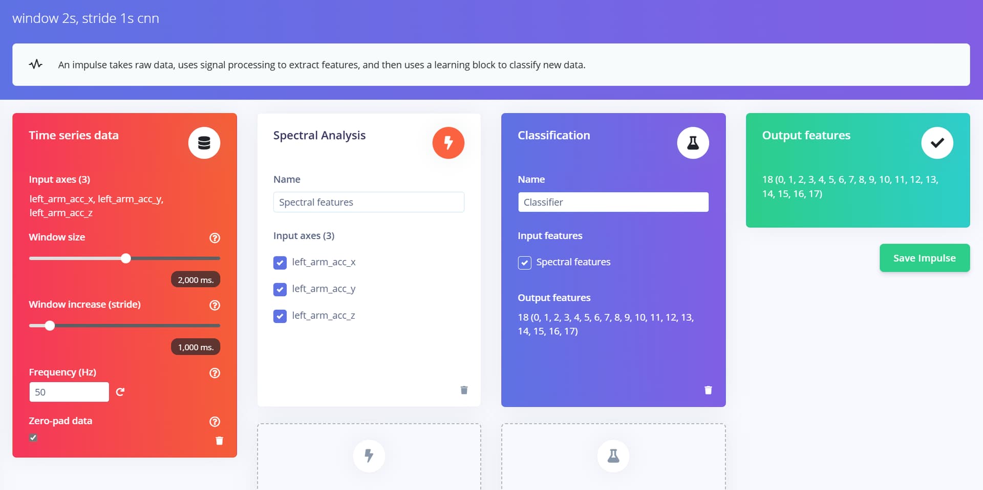

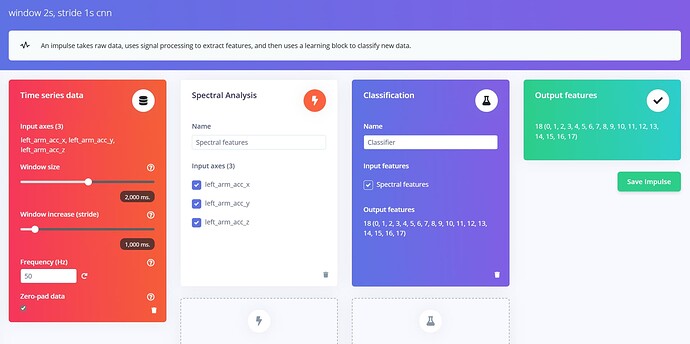

  • Project Version: Impulse #window 2s, stride 1s cnn
  • Custom Blocks / Impulse Configuration: NA

My Impusle design:
HI @quangp
This is common to happen when you change some settings between training
  • Your model was trained with input windows of 24,248 values, but the test sample you’re using has only 12,124 values.
  • This usually happens if:
    • The window size or stride changed after training.
    • You’re testing with data collected under a different sampling frequency or duration.
    • There’s a mismatch between the DSP block output and model input.
Retrain all blocks again with the new settings.

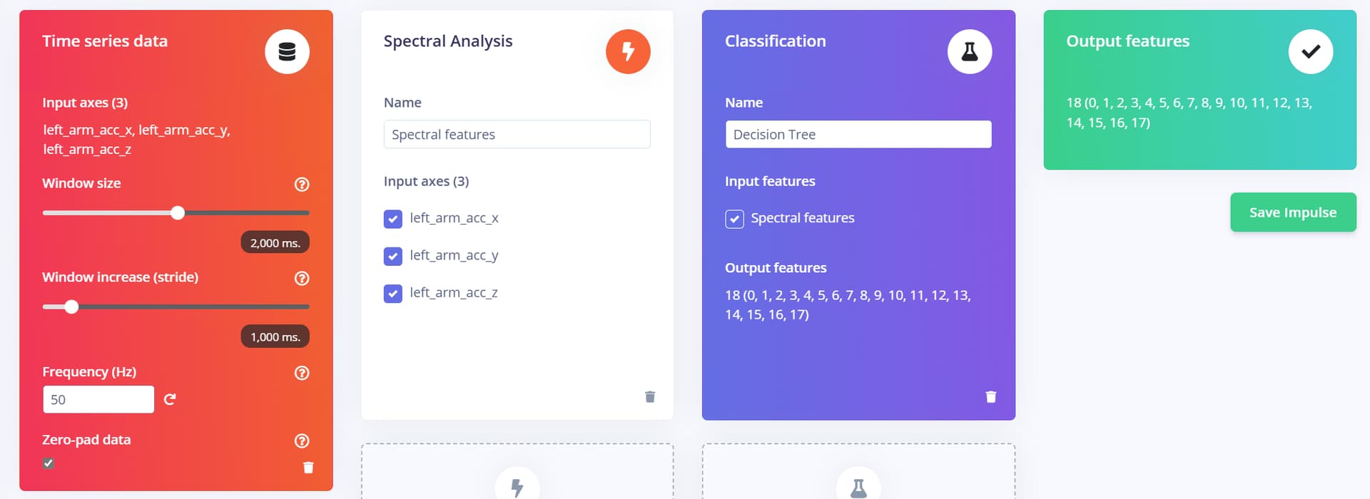

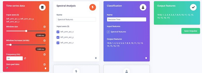

Hi @Eoin, in my case, I collected data with a duration of 4 seconds. Then I proceeded to create a 2s window, 1s stride as below.
Should I recollect data with only 2 seconds?
