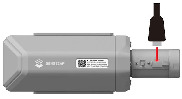

Can you confirm what chip target you are using? it looks like the wrong varient was selected see https://docs.edgeimpulse.com/docs/edge-ai-hardware/production-ready/seeed-sensecap-a1101#id-1.-update-bl702-chip-firmware
Please confirm your setup and the steps you are performing to get the:
  • correct chip target is selected in Boufallo IDE
  • How you are putting the DevKit in bootmode:
    Connect the A1101 to the PC via a USB Type-C cable while holding down the Boot button on the A1101.
See here for more detailed steps, it looks like a step was missed but please let us know if the steps were followed and we can try to investigate further.
