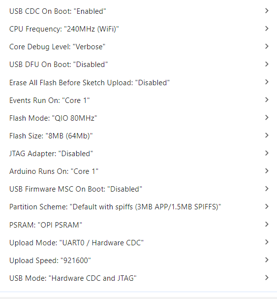

  • Platform: Seeed Studio XIAO ESP32-S3 Sense board
  • Build Environment Details: Arduino IDE 2.3.5 , Arduino Core for ESP32 v3.3.7

  Arduino FQBN      : esp32:esp32:XIAO_ESP32S3:UploadSpeed=921600,USBMode=hwcdc,CDCOnBoot=default,MSCOnBoot=default,DFUOnBoot=default,UploadMode=default,CPUFreq=240,FlashMode=qio,FlashSize=8M,PartitionScheme=default_8MB,DebugLevel=verbose,PSRAM=opi,LoopCore=1,EventsCore=1,EraseFlash=none,JTAGAdapter=default
