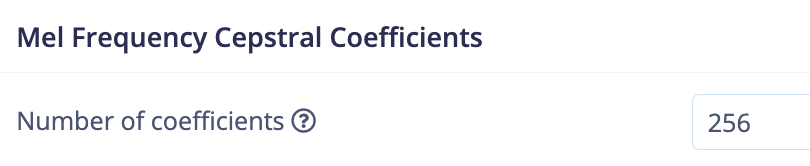

I’m trying to run an audio classification model on a raspberry pi zero or raspberry pi 5. I’m able to successfully build the model for deployment on linux AARCH64 (for pi 5) and AARCHv7, but when i run the model using the edge-impulse-linux-runner command, the model fails with error code -5. I have a usb mic attached to the pi which get recognized by the model and i have tuned it to match the input frequency required for the model and have played around with different windowing samples.

Custom Blocks / Impulse Configuration: [impulse configuration]
included above
