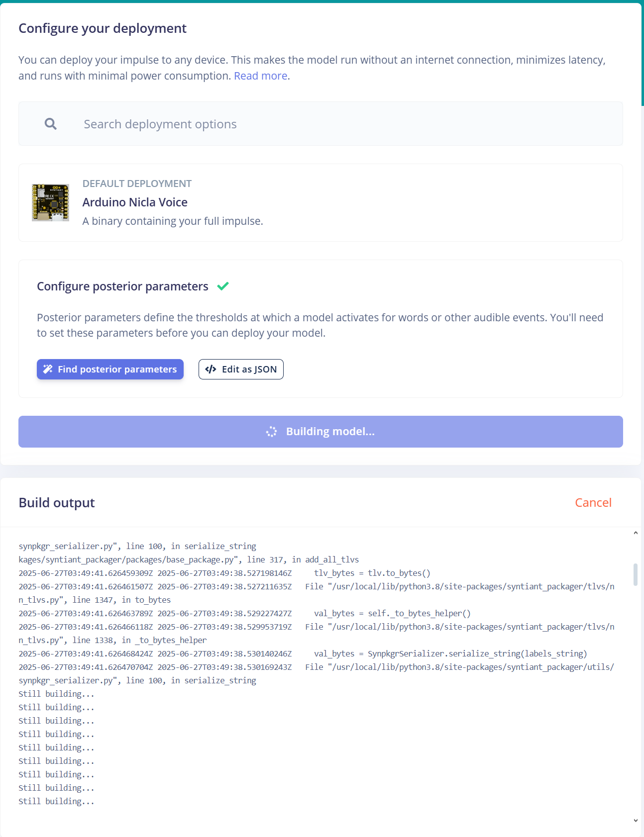

Everything works fine but build is stuck at “Still Building”. Is there anyway to overcome this?

    [Include any logs or screenshots that may help in diagnosing the issue]
image_2025-06-26_231103415

Hi @Thanos03
There’s an error in the log, and the job is not canceled correctly.
thank you for reporting, I’m investigating.
Hi @Thanos03
the problem was one of the label, the ' character is not allowed, I have renamed the wrong label and now it builds.
