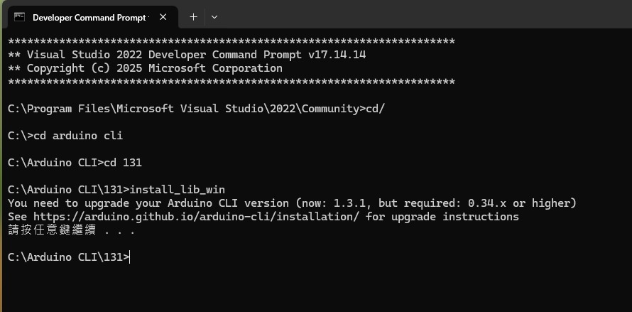

I have downloaded the Arduino CLI 1.3.1 and 0.34.2 and the audio firmware. When I run install_lib_win, please see enclosed scan the prompt said the below messages:
You need to upgrade your Arduino CLI version (now: 1.3.1, but required: 0.34.x or higher)
See Redirecting for upgrade instructions

Hi @kelvinng_rmit
thank you for reporting, I’m fixing now.
Meanwhile, you can downalod and use this one:
Or modify line 34 35 from
if !CLI_MINOR! LSS !EXPECTED_CLI_MINOR! (
    GOTO UPGRADECLI
to
if !CLI_MAJOR! LEQ !EXPECTED_CLI_MAJOR! if !CLI_MINOR! LSS !EXPECTED_CLI_MINOR! GOTO UPGRADECLI
