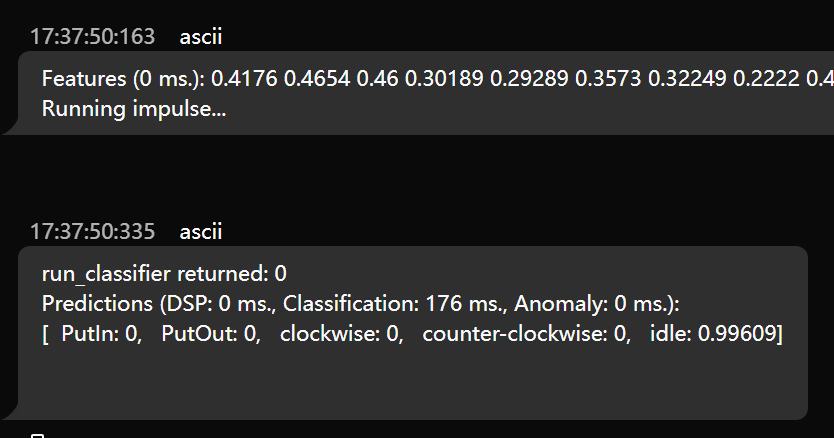

To test the deployed model, I copied a raw data sample from my test set (specifically, one with the label “PutIn”) and pasted it into the features[] array in the code, as instructed.
However, the serial output consistently shows the “idle” class with a confidence of over 0.9. I have also tested this with samples from other classes, and the result is always the same—it classifies everything as “idle” with high confidence.

Sorry to hear this, can you try unoptimized float 32 and see how it works?

see this post: Assistance Needed with Edge Impulse Inference on STMicroelectronics B-L475E-IOT01A Board - #17 by ei_francesco
This looks quite similar to my issue here: https://forum.edgeimpulse.com/t/numpy-log-implementation-in-numpy-hpp-fails-on-portenta-h7-cortex-m7/16927
You could do a quick test to check that:
#include "edge-impulse-sdk/dsp/numpy.hpp"
printf(“log(2.7)=%f\r\n”, numpy::log(2.7));
This should return log(2.7)=0.993252
