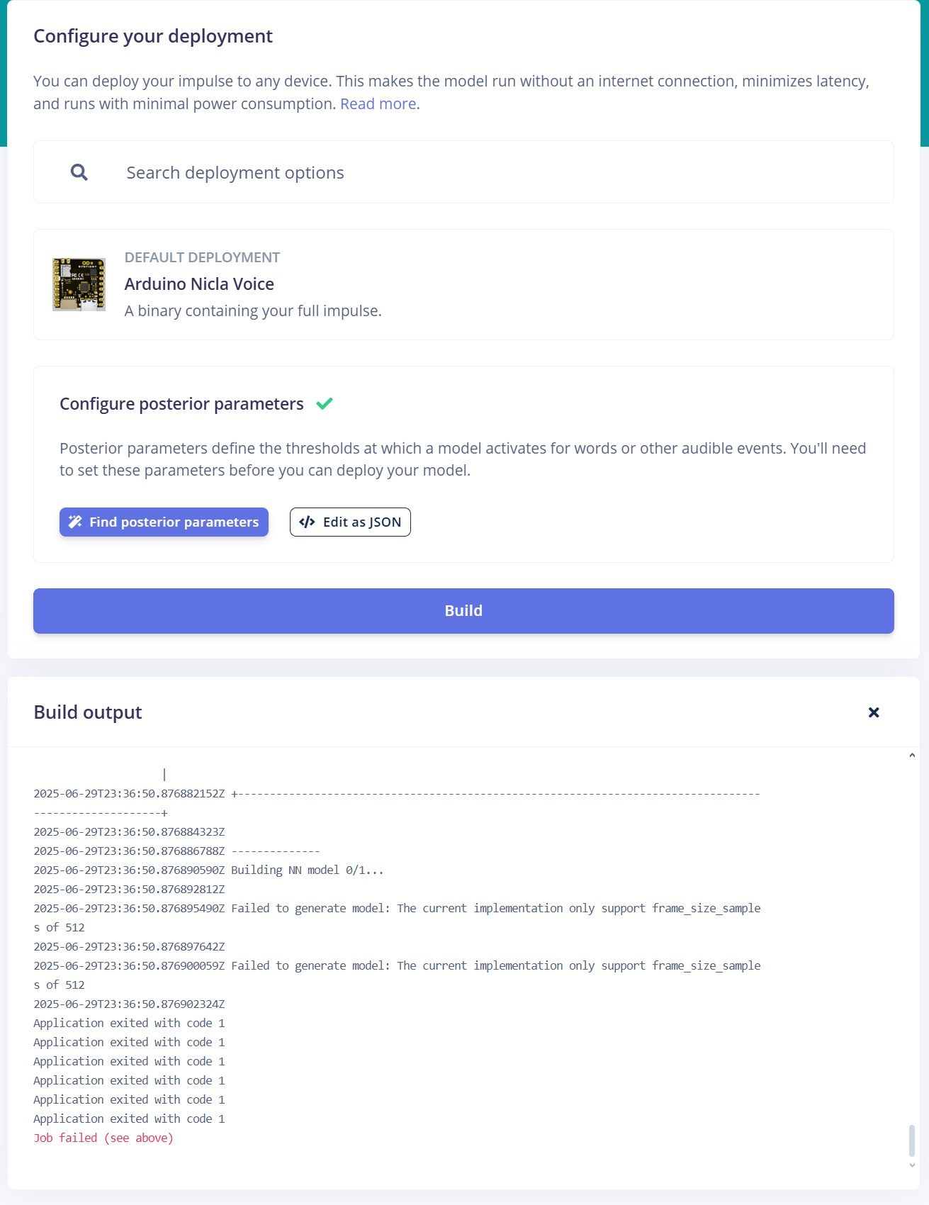

-Hi, after the frame length setting is changed in Syntiant, there is an error: Failed to generate model: The current implementation only support frame_size_samples of 512 while the firmware for Nicla Voice is building. Is there a solution to this?

-Happens when building the firmware.
  1. Convert the frame length value to default
  2. Rebuilding & Reset Posterior Parameters
  3. Restart training
-Firmware should be built fine.

  • Custom Blocks / Impulse Configuration: Using 200 training cycles and 0.0025 learning speed & 0.025 frame length
image_2025-06-29_184315530
Solved: Create another Impulse solve the issue.
