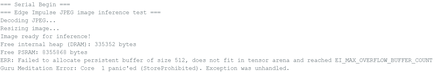

However, during inference, I encounter the following error:
“Failed to allocate persistent buffer of size 512, does not fit in tensor arena and reached EI_MAX_OVERFLOW_BUFFER_COUNT”

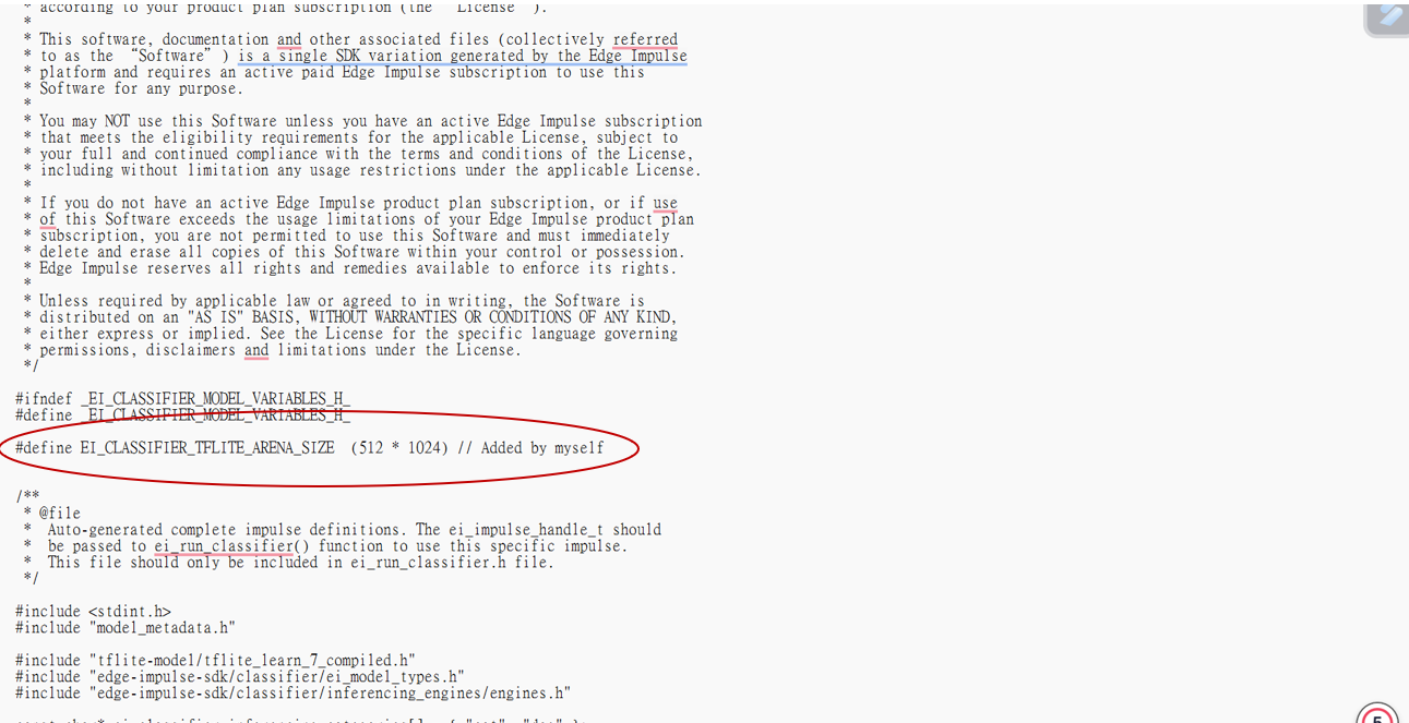

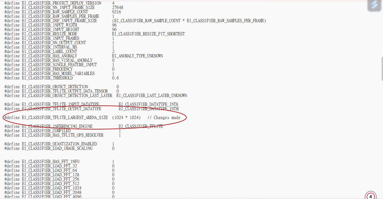

  • Tried manually increasing the tensor arena size by editing the following files:
    • In model_variables.h:

    • In model_metadata.h:
      #define EI_CLASSIFIER_TFLITE_LARGEST_ARENA_SIZE  (1024 * 1024)
Despite these adjustments, the error still persists. Is there any additional configuration needed to fully allocate the tensor arena in PSRAM or allow persistent buffer allocation to succeed?

Hi, @jeremykao2654
Thanks for posting. You are thinking in the right direction, but not changing the correct macros.
You can adjust kTensorArenaSize in the tflite_learn_**_compiled.cpp or EI_MAX_OVERFLOW_BUFFER_COUNT in the same file.

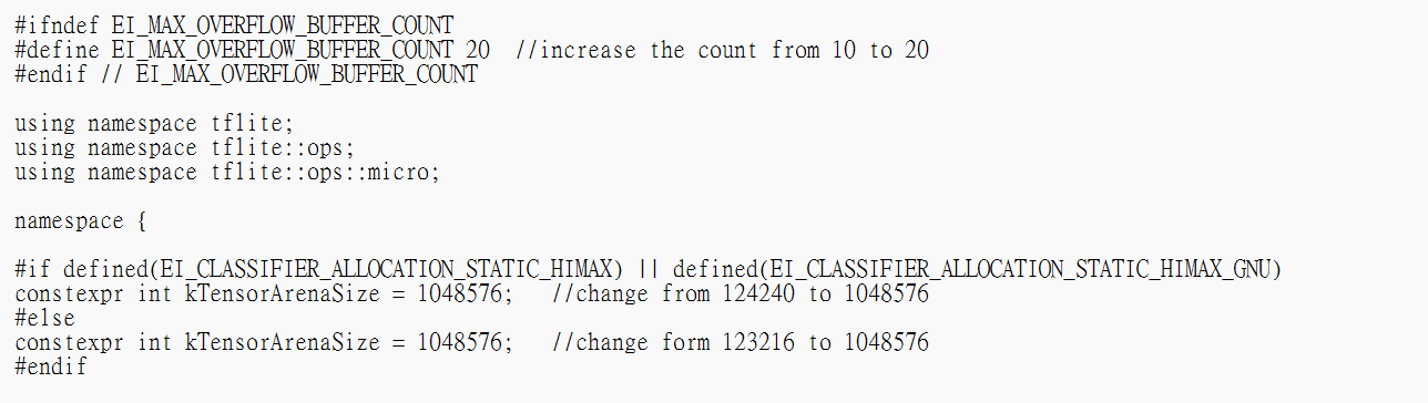

Hi@AIWintermuteAI
I adjusted my EI_MAX_OVERFLOW_BUFFER_COUNT from 10 to 20, but I still get the error. Is this related to FOMO2 0.35?
Have you tried to increase the KTensorArenaSize?
I found a solution, but I don’t know if it is the right one. I modified EI_MAX_OVERFLOW_BUFFER_COUNT in ei_classifier_porting.h and now it works.
