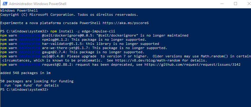

  4. Observe that the command completes and reports success (e.g., “added 548 packages”).

  1. The successful output of the npm install -g edge-impulse-cli command.

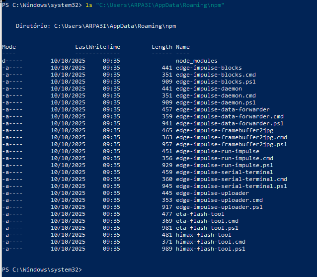

  2. The output of the ls command on the C:\Users\ARPA3I\AppData\Roaming\npm folder, proving the main edge-impulse-cli.cmd file is missing.

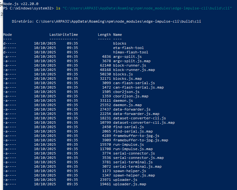

  3. The output of the ls command on the ...\node_modules\edge-impulse-cli\build\cli folder, proving the main cli.js file is also missing.

Hello @jomarleite,
There is no edge-impulse-cli command, the CLI is a wrapper that contains all the other commands. See Edge Impulse CLI - Edge Impulse Documentation
It seems on your case that it was properly installed.
