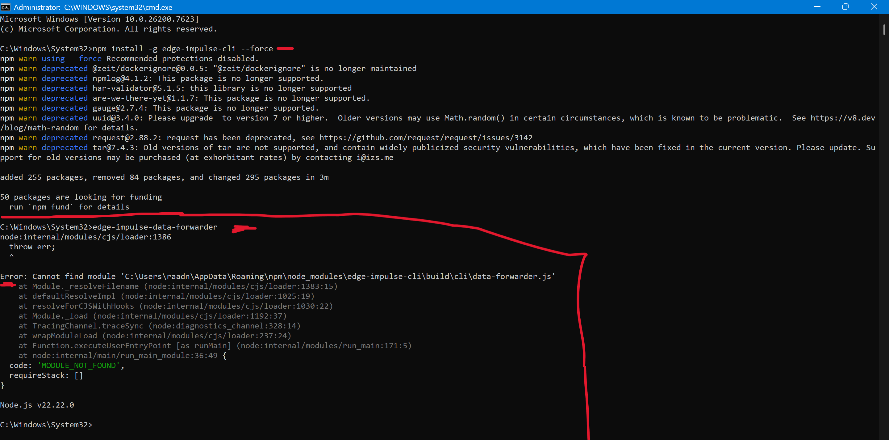

  8. I went to CMD administrator and typed “npm install -g edge-impulse-cli --force” and I didn’t get any errors which was good.
  9. Problem 1: But when I typed “edge-impulse-data-forwarder” I got the message:
Error: Cannot find module ‘C:\Users\raadn\AppData\Roaming\npm\node_modules\edge-impulse-cli\build\cli\data-forwarder.js’ I attached an image for your review.

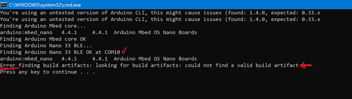

  1. Problem 2: I downloaded the Arduino CLI to flash the device. I downloaded the correct version (Windows exe 64-bit) and extracted the file to the folder “arduino-cli” that I created. I also went to System Environmental Variables and then PATH and added this file to the same “arduino-cli” folder that I made. But when I run “flash_windows” (under download the latest Edge Impulse firmware) in CMD, it shows the message: Error finding build artifacts: looking for build artifacts: could not find a valid build artifact. I also attached an image for your review.

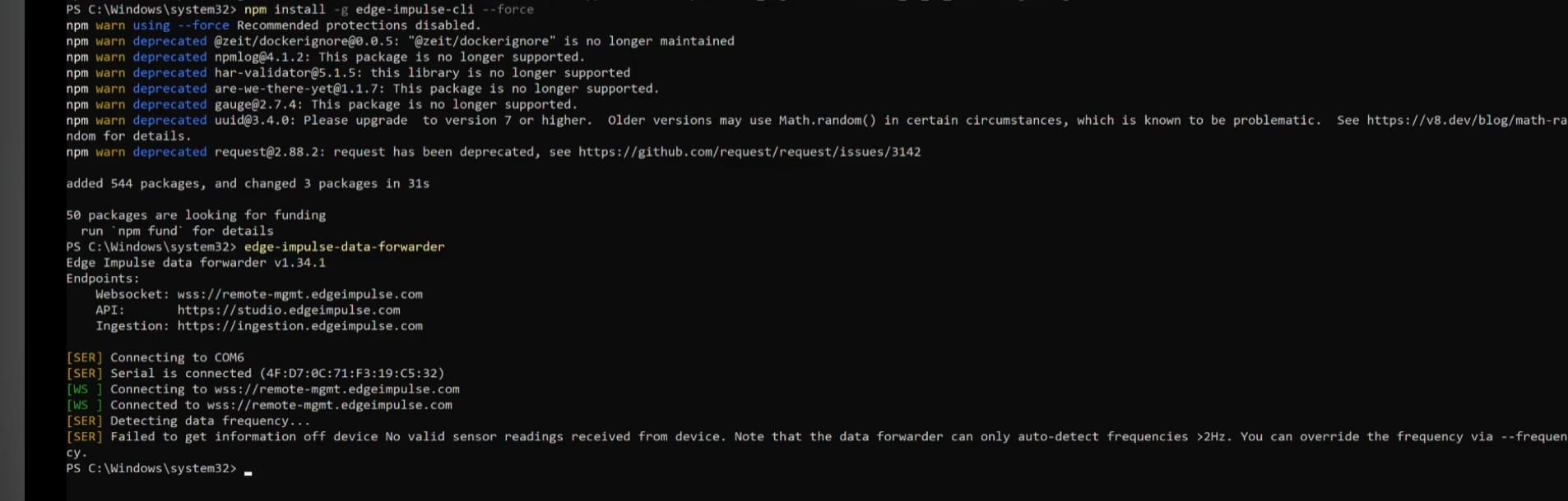

I checked past Edge Impulse forums and one recommendation was to uninstall “edge-impulse-cli” and reinstall, but that didn’t work either. I don’t really know why it’s not working. I also attached an image of what it should look like.
