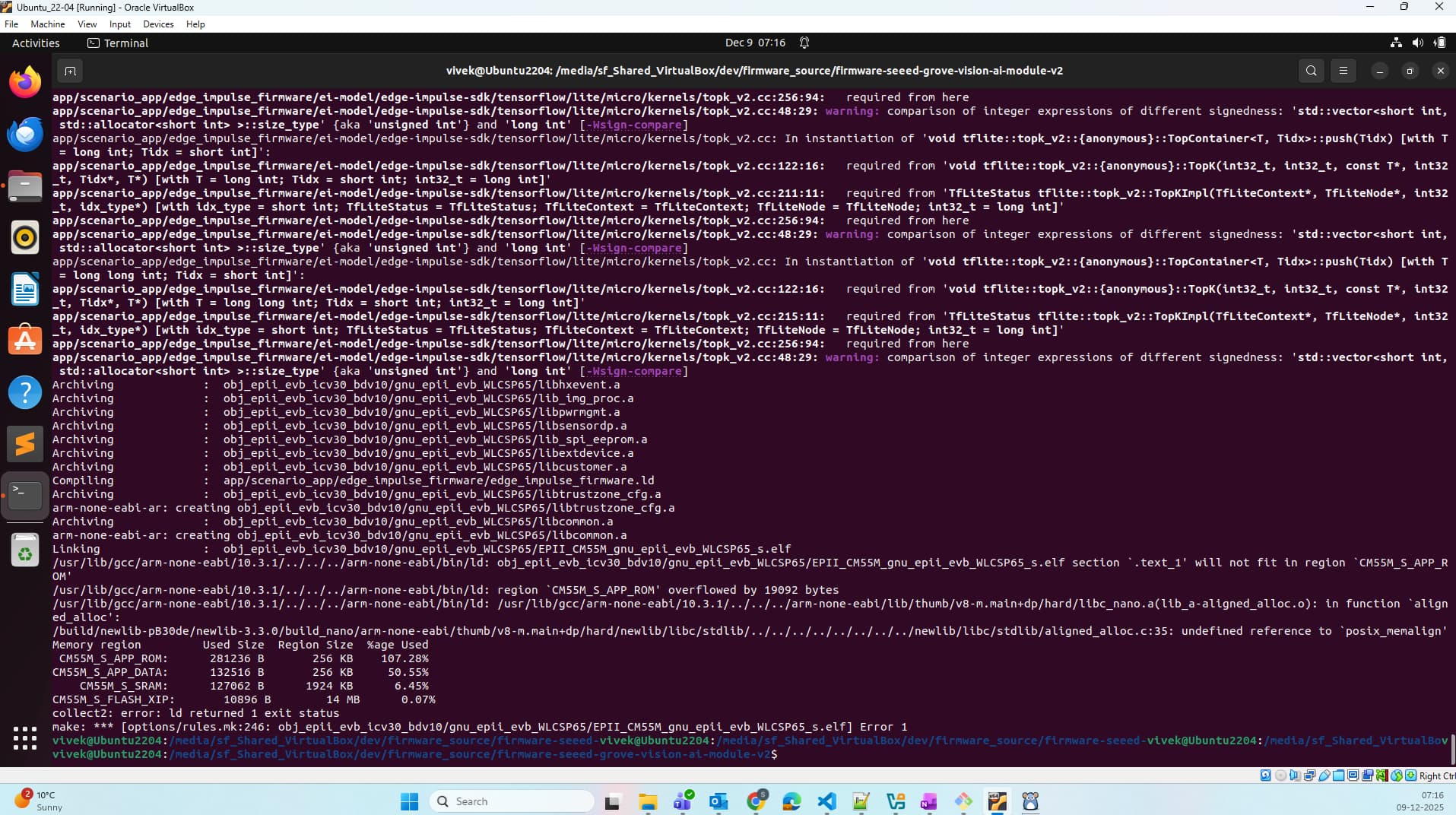

Build failure: .text_1 section will not fit in region CM55M_S_APP_ROM (firmware overflow)
I’m trying to build the Edge Impulse firmware for EPII_CM55M using the instructions provided in the repository:
./build.sh --build
However, the build consistently fails during linking with the following error:
/usr/lib/gcc/arm-none-eabi/10.3.1/…/…/…/arm-none-eabi/bin/ld: obj_epii_evb_icv30_bdv10/gnu_epii_evb_WLCSP65/EPII_CM55M_gnu_epii_evb_WLCSP65_s.elf section .text_1' will not fit in region CM55M_S_APP_ROM’
/usr/lib/gcc/arm-none-eabi/10.3.1/…/…/…/arm-none-eabi/bin/ld: region CM55M_S_APP_ROM' overflowed by 19092 bytes /usr/lib/gcc/arm-none-eabi/10.3.1/../../../arm-none-eabi/bin/ld: /usr/lib/gcc/arm-none-eabi/10.3.1/../../../arm-none-eabi/lib/thumb/v8-m.main+dp/hard/libc_nano.a(lib_a-aligned_alloc.o): in function aligned_alloc’:
/build/newlib-pB30de/newlib-3.3.0/build_nano/arm-none-eabi/thumb/v8-m.main+dp/hard/newlib/libc/stdlib/…/…/…/…/…/…/…/…/newlib/libc/stdlib/aligned_alloc.c:35: undefined reference to `posix_memalign’
Memory region Used Size Region Size %age Used
CM55M_S_APP_ROM: 281236 B 256 KB 107.28%
CM55M_S_APP_DATA: 132516 B 256 KB 50.55%
CM55M_S_SRAM: 127062 B 1924 KB 6.45%
CM55M_S_FLASH_XIP: 10896 B 14 MB 0.07%
collect2: error: ld returned 1 exit status
make: *** [options/rules.mk:246: obj_epii_evb_icv30_bdv10/gnu_epii_evb_WLCSP65/EPII_CM55M_gnu_epii_evb_WLCSP65_s.elf] Error 1

Hi @devjonathan ,
The model is too big and doesn’t fit in flash
See
You can try to reduce the size of your model, move some RO data into another region, remove RO data you don’t think you’ll need (full fw has a lot of functionalitis that maybe you don’t need) or change compilation optimization flag.
