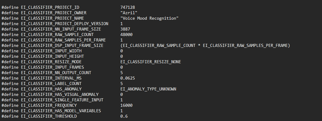

  • Opened model_metadata.h and confirmed:
    #define EI_CLASSIFIER_INPUT_WIDTH 0
    #define EI_CLASSIFIER_INPUT_HEIGHT 0
After successful training and deployment, I expected model_metadata.h to contain correct input shape values (e.g., 13x49) based on MFCC settings, so inference can run properly.
Model_metadata.h always contains width and height as 0. Sketch compiles but inference fails or behaves incorrectly due to zero input shape.

Hi, @Azril !
EI_CLASSIFIER_INPUT_WIDTH and EI_CLASSIFIER_INPUT_HEIGHT are only used for images. So for the audio project they should be set to 0 indeed.
So, that is not the reason the inference does not run.
It could be helpful if you provide more info on what goes wrong during the inference.
