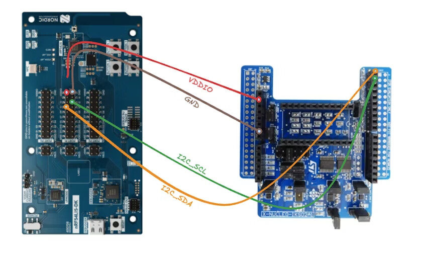

The wiring labels of the I2C sensor connection to the nRF54L15DK in the Nordic Semi nRF54L15 DK - Edge Impulse Documentation are reversed.
the pin connection are correct, just the labels need to be reversed for SDA and SCL
Excellent analysis @Koppu let me loop in @vojislav or @jbuckEI to get the source image fixed.
Hey @Koppu,
Thanks for reporting this! I fixed the image and soon it will be updated in the docs.
Cheers,
Vojislav
