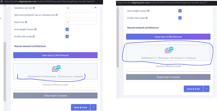

@jorduino Thank you very much for your reply and suggestion! The project link is: Audio - Dashboard - Edge Impulse.
And the pre-trained model for transfer learning is MobileNet1.0 and MobileNetV2, which are provided by Edge Impluse. Both of them have input shape 99x40x1, and their weights should be trained by Edge Impluse. As following snapshot,
I want to know if I can get the dateset for pre-training these two models, because I want to change input shape from 99x40x1 to about 120x40x1. I saw the accuracy of transfer learning based these two models with 99x40x1 is good. So If can’t get the original dataset or its probability distribution, I can’t train a model having good accuracy in later transfer learning when changing input shape from 99x40x1 to 120x99x1.
Not sure the dataset for pre-training these two models is the ones “audio/keyword-spotting” and “audio/faucet-vs-noise” in the link you mentioned.
Please help me. Thank you!
Would any buddies of Edge Impluse tell me which dataset is for training the pre-trained MobileNetV1 and MobileNetV2 in the project of keyword spotting? Audio - Dashboard - Edge Impulse
