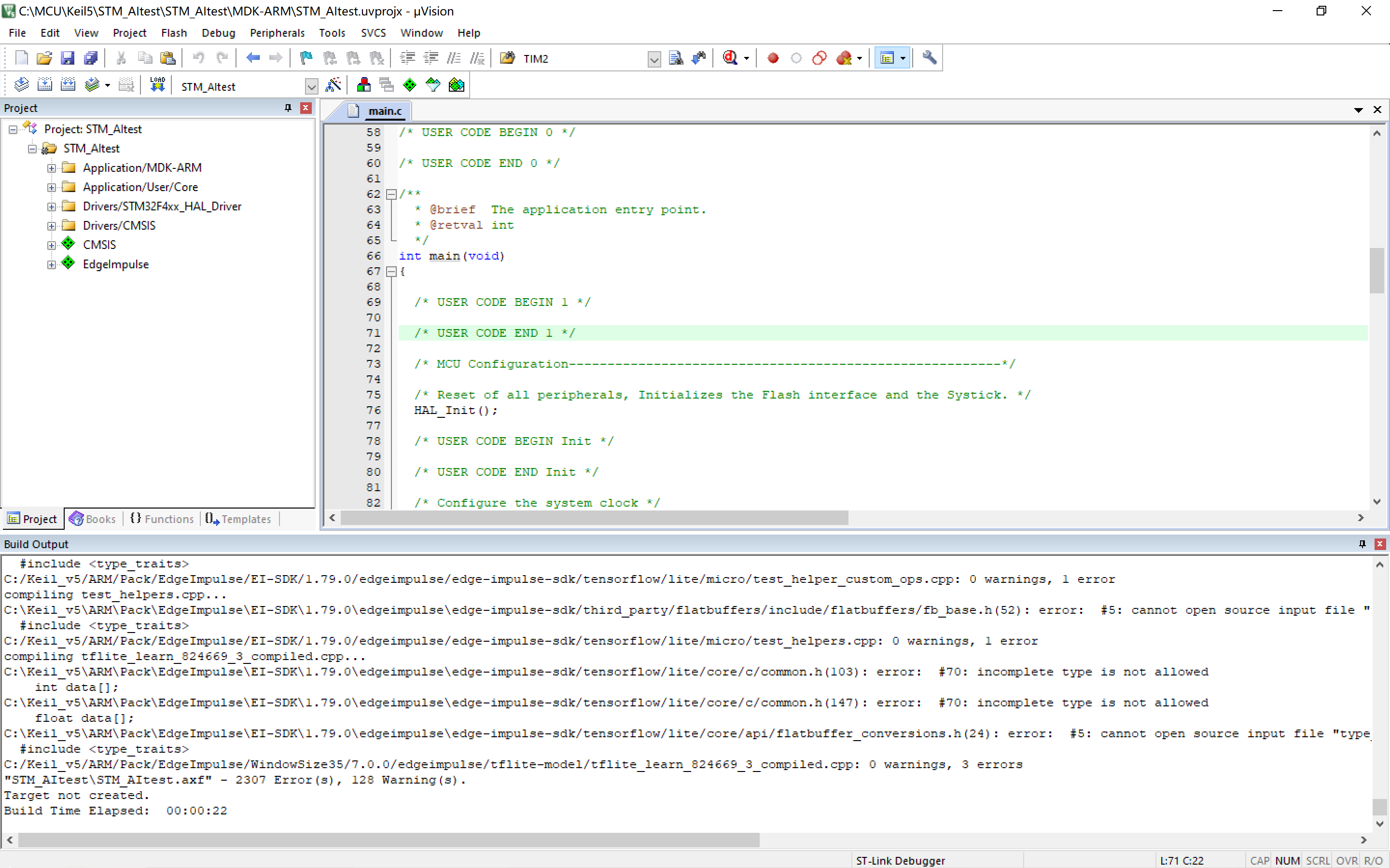

I used cubeMX to generate the MDK project for the stm32f407vet6, and then imported the Open CMSIS pack generated on Edge Impulse Website. After compiling, a lot of errors appeared, which left me completely clueless.plz help me.

well,It should be compiled using ArmCompilerv6.

very thk! :) i solved main problem by using an Arm Compiler higher than v5. i have almost never used C++ on Keil, obviously a beginner.
But the new minor issue is that after compiling, there are two errors: ‘arm_convolve_wrapper_s16’ and ‘arm_svdf_s8’ functions cannot find a match. Thanks for the example link you provided, I will take a look.
