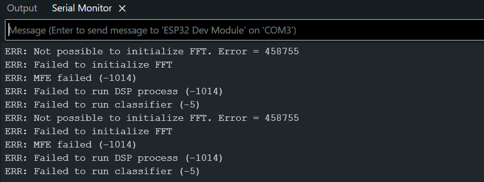

Hi, I am getting the following error when I try to deploy to the ESP32. My project is on audio classification of security-critical sounds. Please do get back as soon as possible as my project is due soon. Thanks!
1053549
[Provide context or use case where the issue is encountered]
  1. Downloaded model zip from Edge
  2. Revised the mic_continuous code for my project
  3. Attempted to upload/troubleshoot
  • Platform: ESP32-WROOM-32D
  • Build Environment Details: Arduino IDE 2.3.10
  • OS Version: Windows 11
  • Custom Blocks / Impulse Configuration: MFE Impulse

Hi @TrishtaAnn !
Have you tested with static_buffer example, as described here
Do test - and if it works as expected, the problem is in your code (the fact it reports Error = 458755 is specially interesting, looks like memory corruption, since it is unlikely to be an actual error code). If static_buffer example does not work - please post the output here.
