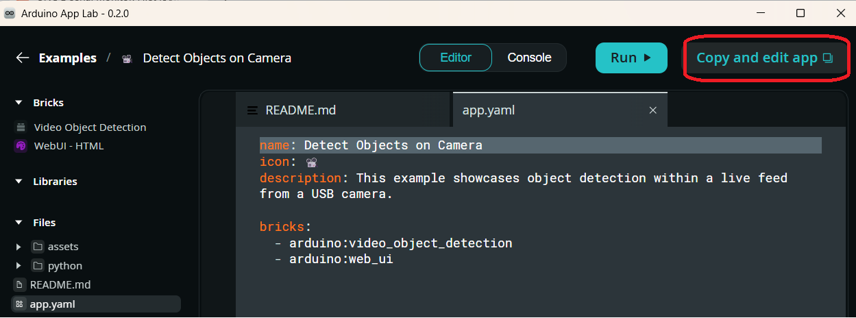

@marcpous I just found out that I can copy the Edgeimpulse object detection example, then edit the app.yaml (irritatingly using nano since AppLab does not allow editing it). If the model is in my .arduinoBricks, it should work without any other changes, making it much easier to make an edgeimpulse model run, but it is not working for me. Any suggestions? Does the concept make sense?

I am just trying to duplicate the Object Detection example, but once duplicated it does not run. I am not having consistent success using your steps ( here ) so I am trying to find an easier method.
Run the object detection example to make sure it runs
Duplicate the example
Run it, it doesn’t work since it is an example.
Then convert the app.yaml to your app.yaml and put my model in the .arduinoBricks folder. Still does not run, complains of an non-overlapping IPv4 error

OK I found part of the problem, copying an example does not copy all the needed code, (but it should). I will see what files folder files are the important ones. I think it is just the main HTML files not the python folder files.
It’s the assets folder that is needed. I will test from here.
~/.local/share/arduino-app-cli/examples/video-generic-object-detection/assets/
The python folder is already properly made with the working main.py. I will test from here.
