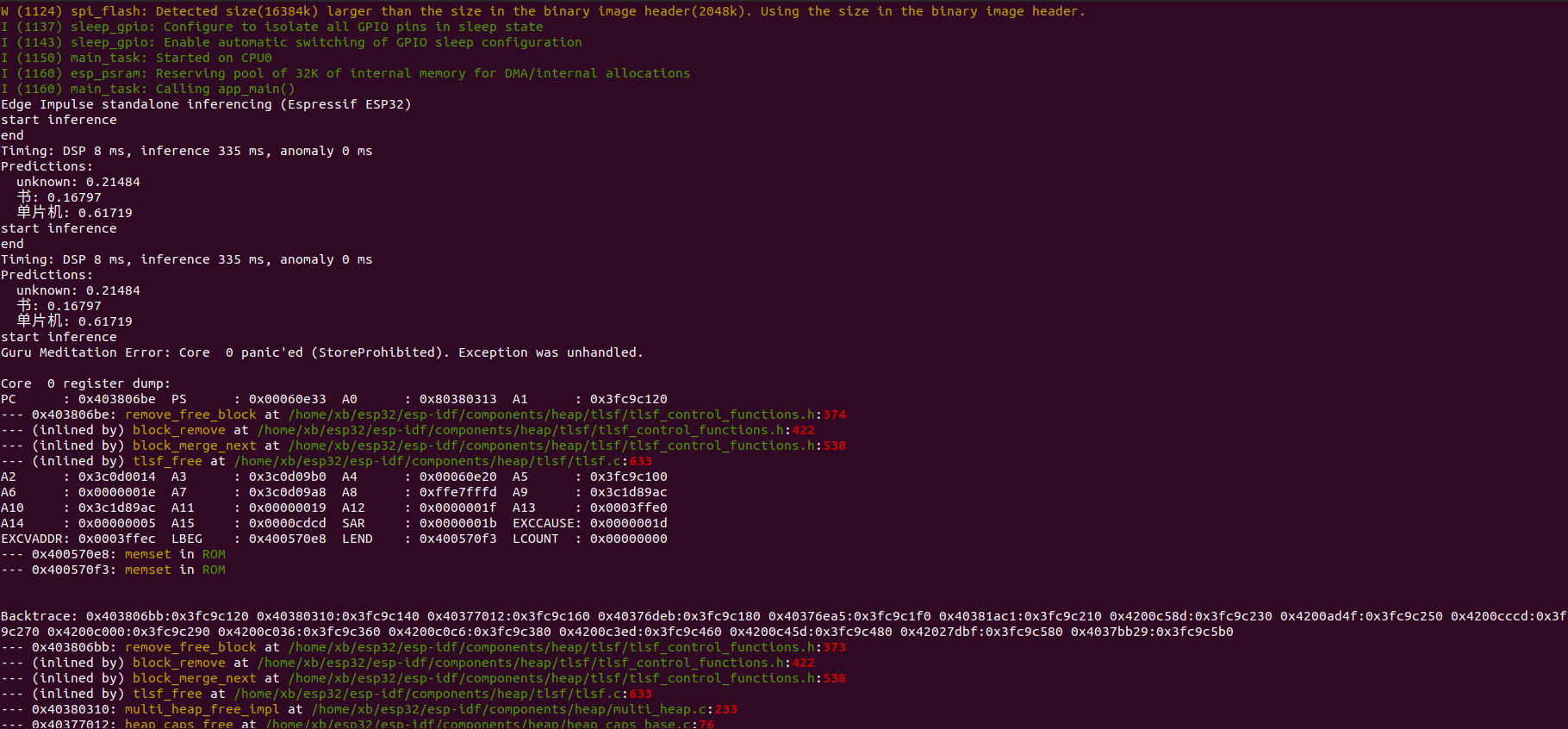

The image classification model deployed on the ESP32 will report an error after running for the third time in the while loop
[Describe the question or issue in detail]
The image classification model deployed on the ESP32 will report an error when run for the third time
[Provide the project ID]
827169
[Provide context or use case where the issue is encountered]
When deploying a sample project using ESP32, I can enter the main loop, but an error occurs during the third run
  1. [Step 1]
    Complete the training of my own classification task in Edge Impulse and generate a C++ link library
  2. [Step 2]
    Copy the generated library to the project at git clone GitHub - edgeimpulse/example-standalone-inferencing-espressif-esp32: Builds and runs an exported impulse locally (ESP IDF)
  3. [Step 3]
    Modify the kTensorArenaSizein
    4.[Step 4]

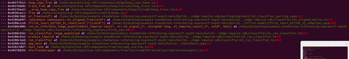

    When the program is burned into the ESP32S3 for operation, the following error occurs
  • **Build Environment Details: ESP IDF 5.4.2
  • **OS Version:Ubuntu 20.04
  • Edge Impulse Version (Firmware): โ€‹latest version**
This is all the error messages

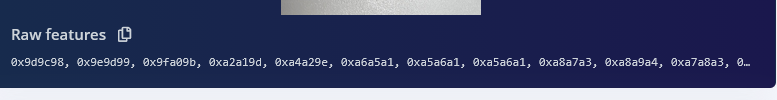

When I was looking at the document, I noticed that the feature in the document is a floating-point decimal, but mine is in hexadecimal. Could this be the issue

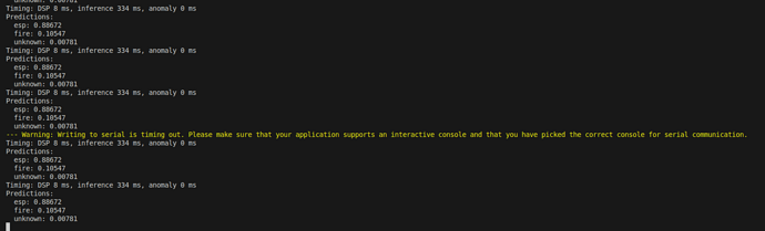

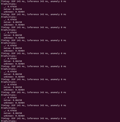

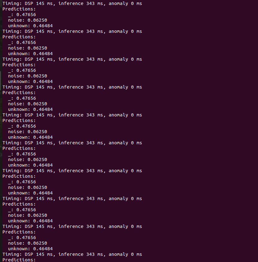

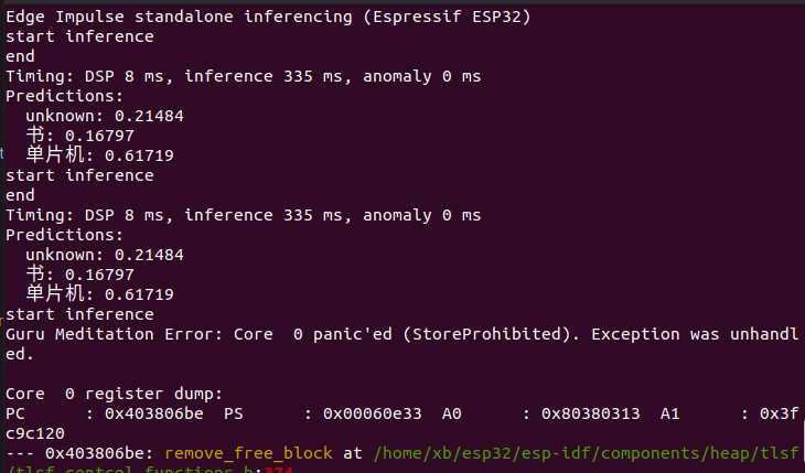

first of all,appreciate your reply .today i rebuild a new project of audio detect not image , it`s working correctly.here is the image of working.
i feel confused and want run image task finally.do you have any idea about this?
Hi, @nova1231 !
Floating-point decimal is correct type for images (itโ€™s three bytes - R, G, B values - crammed into a float), no problem there.
While Iโ€™m trying to reproduce the error, one thing to try is to change class names from Chinese to English. We donโ€™t really test for anything except labels in English language.

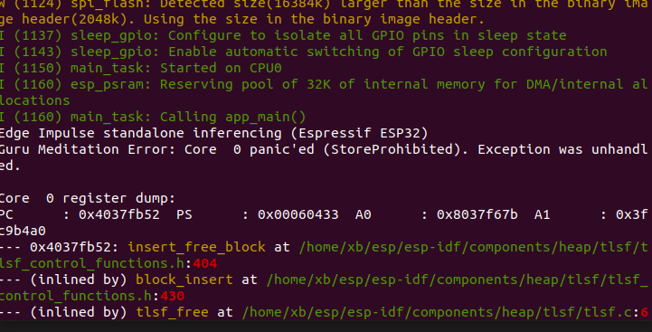

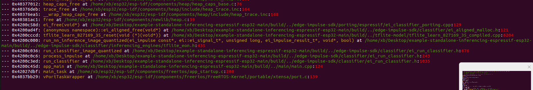

i have tested English label,but still meeting same question.as the image show
The difference is that this time it reported an error upon entering
