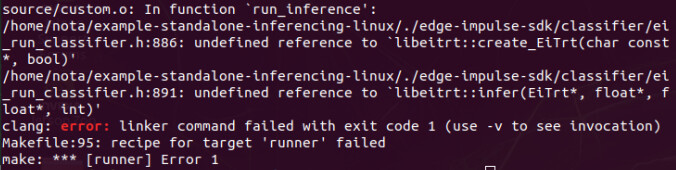

nota@nota-desktop:~/example-standalone-inferencing-linux$ APP_CAMERA=1 TARGET_LINUX_AARCH64=1 USE_FULL_TFLITE=1 CC=clang CXX=clang++ make -j
error message
source/camera.o: In function run_inference': /home/nota/example-standalone-inferencing-linux/./edge-impulse-sdk/classifier/ei_run_classifier.h:886: undefined reference to libeitrt::create_EiTrt(char const*, bool)’
/home/nota/example-standalone-inferencing-linux/./edge-impulse-sdk/classifier/ei_run_classifier.h:891: undefined reference to `libeitrt::infer(EiTrt*, float*, float*, int)’
clang: error: linker command failed with exit code 1 (use -v to see invocation)
Makefile:95: recipe for target ‘runner’ failed
make: *** [runner] Error 1
I’ve already installed the clang through the command.
sudo apt install -y clang
Can you tell me why this problem occurs?

@SunBeenMoon You need to build with these flags: https://github.com/edgeimpulse/example-standalone-inferencing-linux#tensorrt
So:
APP_CUSTOM=1 TARGET_JETSON_NANO=1 make -j
