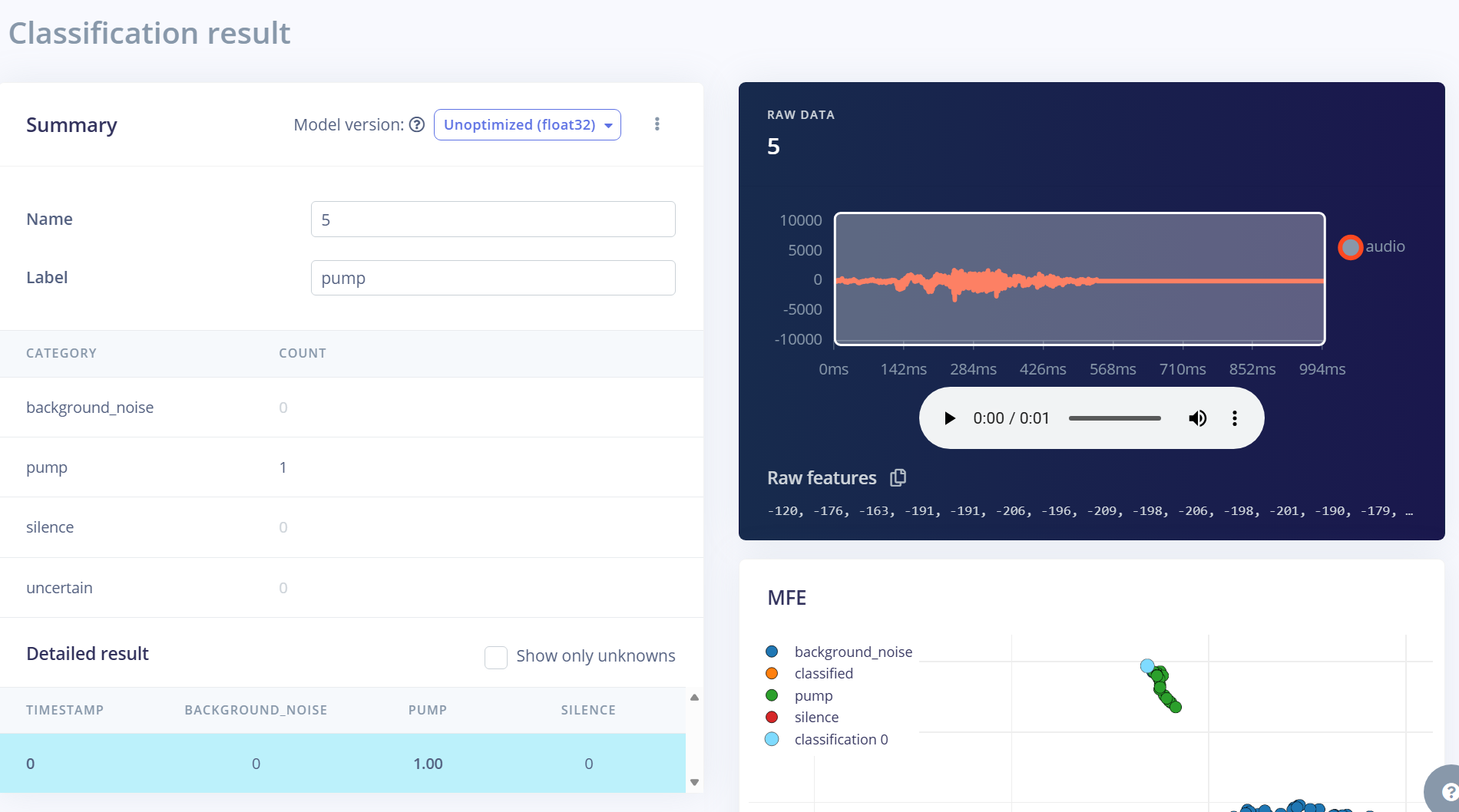

I have seemingly successfully trained an audio classification model. The Live Classification seems to return 100% for my 3 classes which is great and using the Live Classification from my test sample set seems to work great. I build and download, add the library to arduino ide, copy the sample code from static buffer, i get the ‘raw’ data from the test sample i ran in Live Classification…and the results are different.

Below is a screenshot of the Live Classification properly identifying that the audio is in the ‘pump’ class.
I can’t seem to paste the entirety of the RAW data…but this is the first little bit.
static const float features[] = {
-120, -176, -163, -191, -191, -206, -196, -209, -198, -206, -198, -201, -190, -179, -163, -151, -130, -110, -95, -96, -92, -96, -96, -104, -112, -116, -118, -119, -112,.........................................
