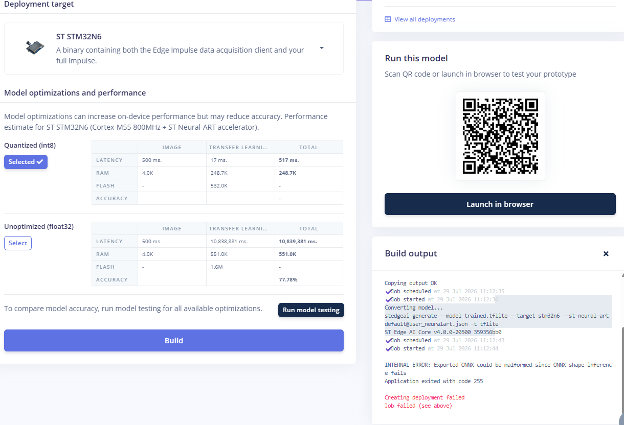

I’m having an issue with the STM32N6 deployment.
I trained a simple image classification model (bottle vs key), but when I select the ST STM32N6 deployment section, it shows an error and cannot generate the deployment.
My board, ST-Link and STMCubeIDE are all working correctly, so the issue appears to be with theSTEM32N6 deployment.
How can i resolve this error?

Hi @shivi8
the error is from the ST Edge AI tool when trying to convert the tflite model with the Neural Art compiler from ST.
Converting model…
stedgeai generate --model trained.tflite --target stm32n6 --st-neural-art default@user_neuralart.json -t tflite
ST Edge AI Core v4.0.0-20500 359356bb0
:heavy_check_mark: Job scheduled at 29 Jul 2026 11:12:43
:heavy_check_mark: Job started at 29 Jul 2026 11:12:44
INTERNAL ERROR: Exported ONNX could be malformed since ONNX shape inference fails
I’m not sure what can be wrong, first time I see this error.
I’ll try to check if I can get any info.
