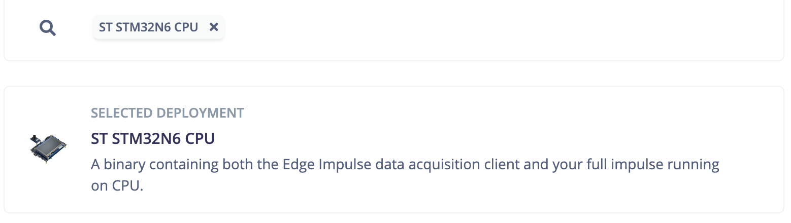

Hi @DJE666 ,
if you are building for CPU, that’s correct, there’s no need to flash the weights as with this build, the inference runs on the MCU, we recently cleaned the output for this build.

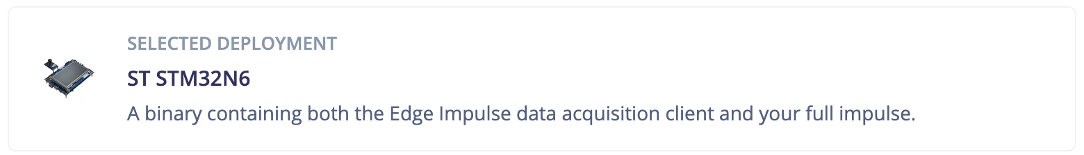

If you want to run inference on the NPU, you need to use this deployment option:

If I am building for the ST STM32N6 CPU target (which does not need the network_weights.hex file), then why does the auto-generated flash.sh file contain a command to program the network_data.hex file when this file is not going to be created?
Should I manually edit the flash.sh file (if so how), or run individual commands to program the dev-kit when the network_data.hex file is missing (not generated nor required).

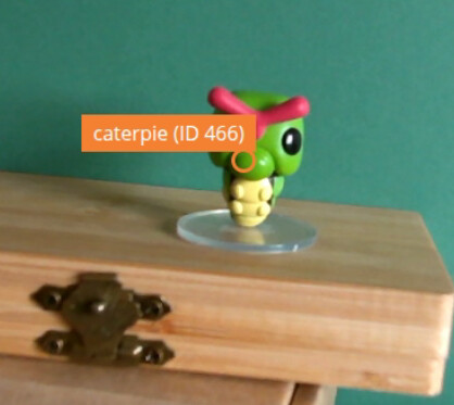

This is the result of the model running in the browser before being ported to the STM32N6 hardware.
FYI this is from project iD 849259.
David

i checked your project, first I would remove the unknown label and the sample associated with it.
But even after that, seems the model is not performing well on device. I tested it with other devices and I can’t get any object detected :frowning: I’ll keep checking; I’m testing pointing the camera to my monitor with one of the sample.
I get the right detection on static inference, so you can try by removing the unknown label, retrain and check on real object, let me know!

Hello FV,
Still no joy even after removing the unknown data set and retraining. Could this be an image format issue? The fact that the SDTM32N6 dev-kit is seeing absolutely nothing, not even a flicker of object recognition, suggests a fundamental detection issue.
