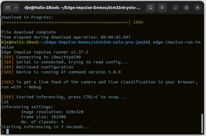

Project iD 851238 builds as expected resulting in a .zip with the required .bin and .hex files to deploy the complete application onto my STM32N6 dev-kit. I can flash the files to the kit and the application starts with the camera output shown on the display and the message “Inference not Running” on the screen.
Running the edge-impulse-run-impulse command on my Ubuntu laptop results in the following screen and the image on the dev-kit freezes until I reset the board.
STM32N6-yolo-pro-lockup-screenshot 27-1-26
Any ideas why this demo will load but not run? I have run more basic Edge-Impulse projects on this dev-kit successfully in recent weeks, so I know that the basic HW/SW setup is good.

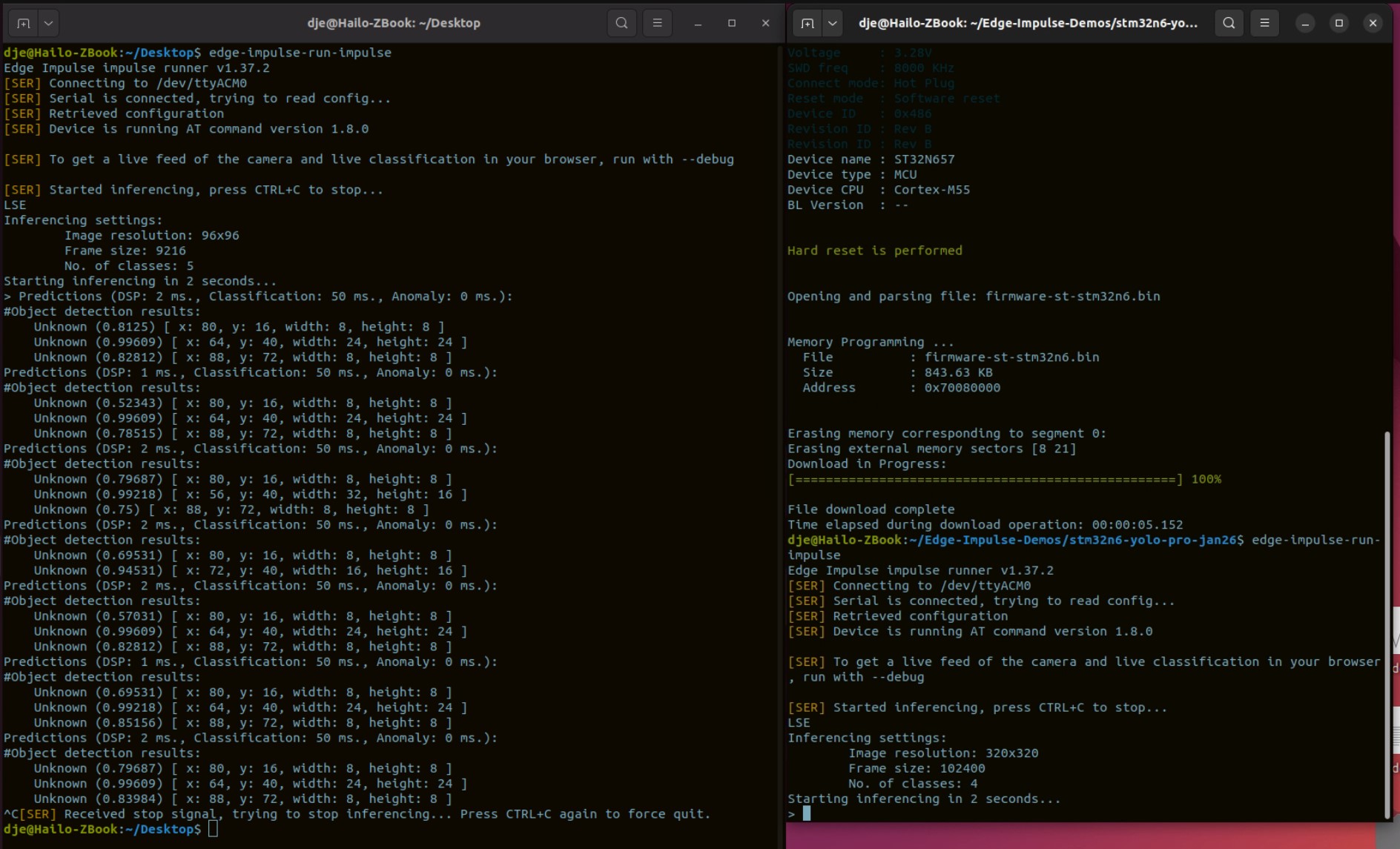

Hello FV,
Thanks for the feedback. Attached is a screenshot of the STM32N6 dev-kit running an older project (CPU only) (left), but stalling on a new project (CPU + NPU) Right.
STM32N6-EI-Good-Bad-3-2-26
The --verbose output is realized as a serial stream, so I cannot capture a meaningful screenshot of the output. Can I attached a file to this support ticket?

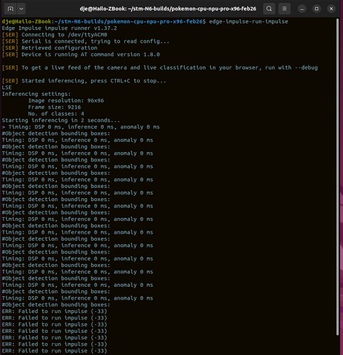

Hello FV.
I rebuilt the Edge-Impulse project 851238 with image-size of 96x96 and the new impulse runs for a while on the STM32N6 dev-kit (which does not lock up). However no objects are detected and then the edge-impulse-run-impulse appears to crash.
Running the –verbose option adds nothing to the output, but does trash the format.
