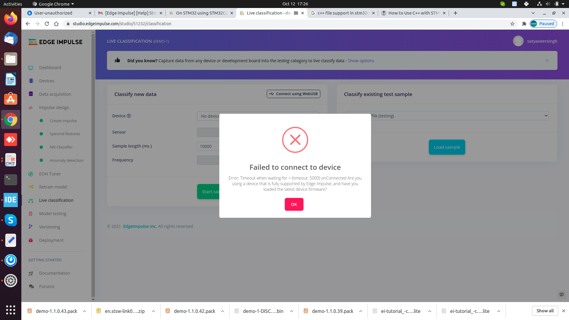

Hello @jenny
I am interfacing UART Dongle with the STM32l412 Board. I am trying to open the COM Port detected by the Uart Dongle on the Edge Impulse inside the Live Classification but i am getting the Errors.
I have attached the Image Which is describing the Error Message in detail.
please Guide me.
Hi @satyaveersingh, just saw this reply.
Have you been able to get the UART working? Can you describe what firmware you have flashed to the board?
Thanks!
