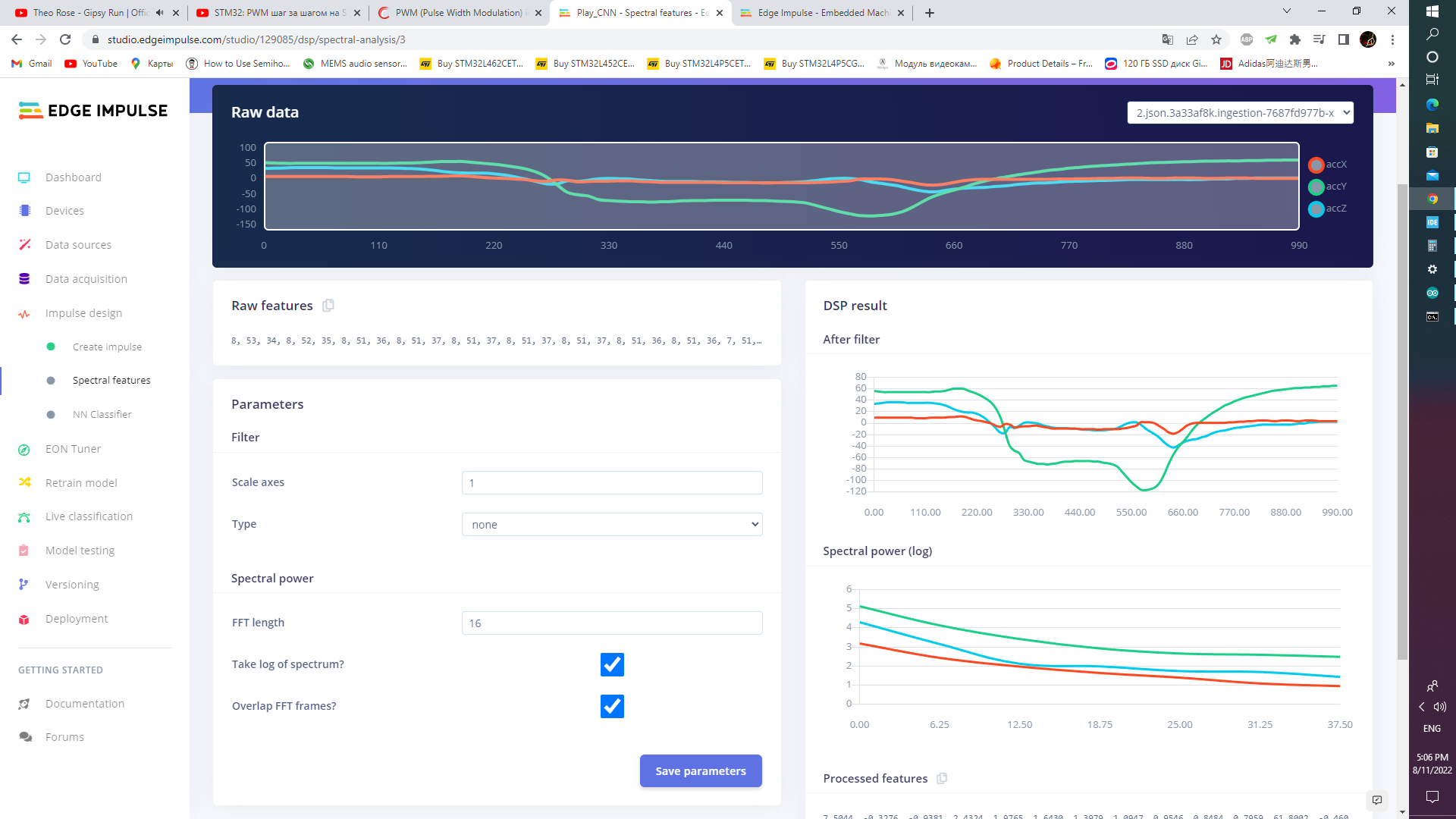

Hello Edge pulse team, can you tell me where the parameters in the Spectrum Analysis are not shown

hi yes i already used v2 in v1 i got better results because i could change the fft parameters.I took version 1 from git and added custom block after deployed to microcontroller, will it work or do i have to implement this block myself (v1)?

yes of course I can add, I tried to train the model using v2, it turned out a little worse and then I tried to add a bone block and got better results (v1)
Project ID 127696 , now i used v2 but yesterday using v1 i got 99% accuracy
Hi @norik.badalyan , thanks for sharing your work. I achieved 100% accuracy (0.03 loss) with v2 by applying a low pass filter. There’s double goodness in v2 for filtering…in addition to applying a Butterworth filter to the input signal, we also achieve dimensionality reduction by removing FFT bins above/below the cutoff frequency. Less dimensions means less data needed for good results!
I didn’t overwrite your DSP block settings or your trained NN. I added my work as a new version. You can see the results here: Login - Edge Impulse. Note, if you want to to deploy that model, you have to select “Set version as primary” in the version control for the NN version I trained.

Hi @AlexE , please look with v1, my result is better than in v2.
First I tried it on v2, I got 98.21 maximum in training and 92 on test, and on v1 100 in training and 97 on test
Hmm, did you run that with the settings I applied to v2? (You would have had to go into the versions of both the block and the NN to see them…I didn’t want to stomp on what you already had). Since what I noted was 100% accuracy, I think you’re still running v2 with default settings perhaps, which I agree, did not hit 100%
