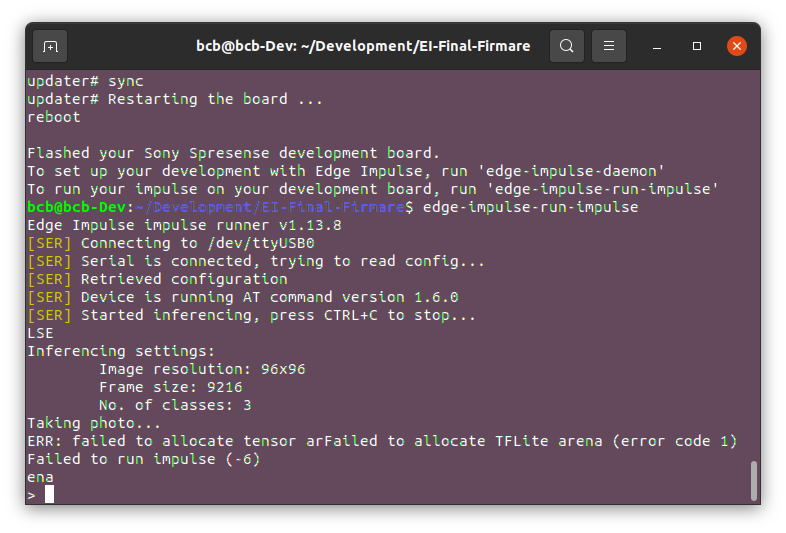

I tested the new added features for the Sony Spresense. The firmware for all the sensors (Cam, mics and accelerometer), capturing data went OK. Now, when I flashed the package I found one problem and one question:
1)- I used the cli to run the camera inference and I got an error telling me that it couldn’t allocate tensors. (See the screenshot)

I also had this problem. Tested different models to check the behavior after flashing. If the model becomes to big, then edge-impulse-run-impulse might not even start inferencing.
[SER] Serial is connected, trying to read config...
[SER] Failed to get info off device:undefined. Is this device running a binary built through Edge Impulse? Reconnecting in 5 seconds...
The largest vision model I’ve tested and that could be executed so far is MobileNetV2 0.05.
Any plans by Edge Impulse to flag in the deployment/build process when model exceeds available device resources?
You’re right, large vision models won’t run on the smaller boards. MobileNetV1 usually give the best results on embedded targets.
For most targets, the compiler returns an error in the build process. Sony build doesn’t return an error, because it uses heap memory (so it’s a runtime error). But it’s a good idea to create a separate mechanism for Sony to determine if the model fits.
