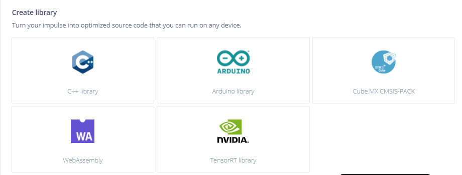

I finished a keyword spotting application with edge impulse, which includes process of mfcc module, NN classifier(use 1D default neural network), and then I wanna deploy the model into C++ library.
