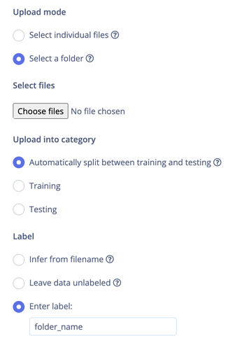

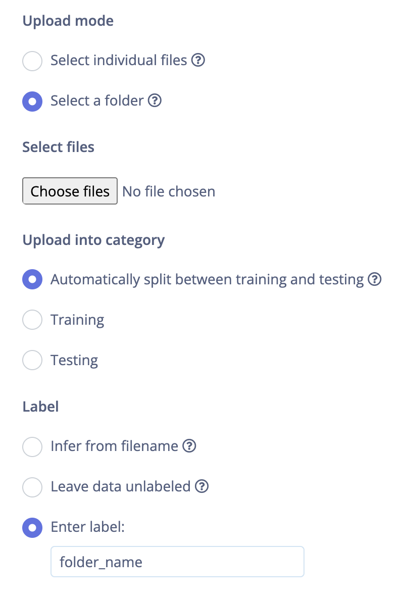

Hi @DJE666
I’ll pass this feature request on to the team. As a workaround for now you may find it useful to upload each subfolder with a fixed label:
Alternatively for larger projects I often upload using our ingestion API and a short python script- giving much more flexibility in how you structure your dataset and the ability to append metadata: Ingestion API - Edge Impulse Documentation
