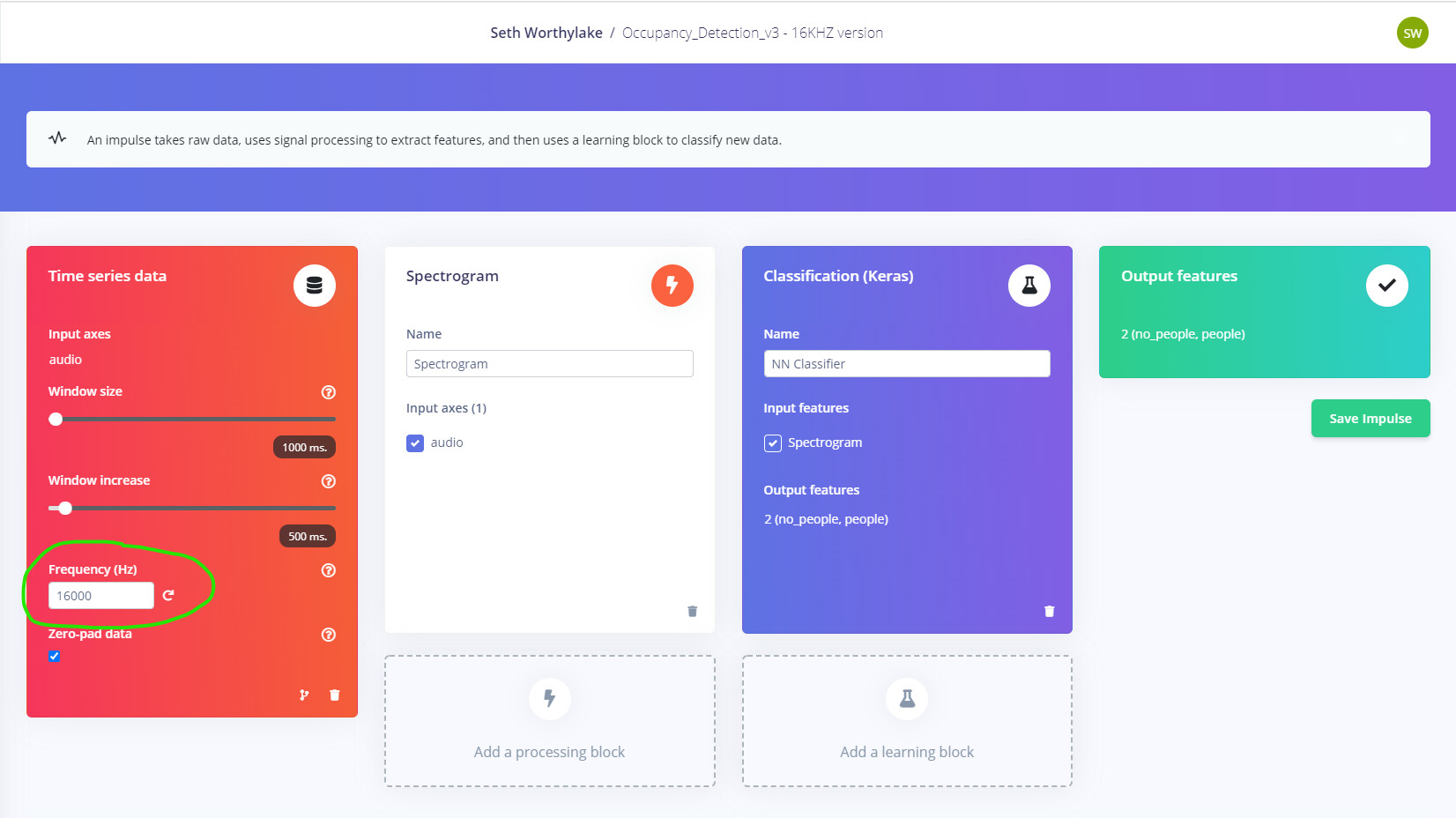

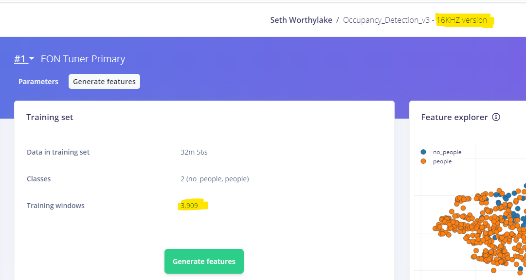

Hey @jenny I was also wondering, across my many different sample frequencies I have noticed that as my sampling frequency goes down my number of Training Windows goes up. Like as in these projects where my sample window is 1000ms and my window increase is 500 ms. And as the sampling frequency gets halfed, the number of training windows double. Why does this correlation happen?
Indeed the number of training windows increasing is a bug when estimating the number. This is not changing the number of windows once you generate features, but the issue has been added to our backlog.
