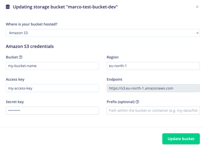

Hi @kaifish
After reviewing your S3 configuration deeper it would seem that you are trying to use the ARN incorrectly for this S3 bucket:
Can you try reformatting your bucket to the following:
Hope this helps,
You might be seeing an old attempt to make it work, trying different options. I just tried again with the correct name, region, etc and it still is not working.
