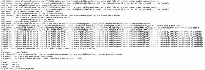

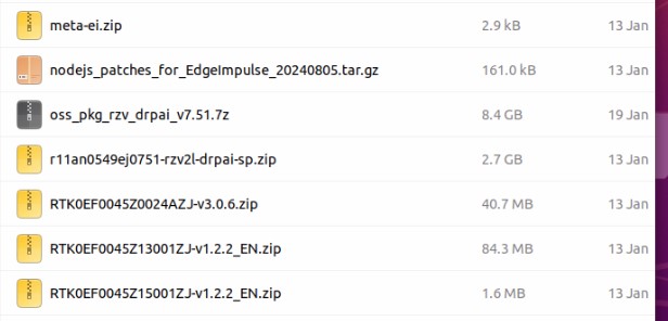

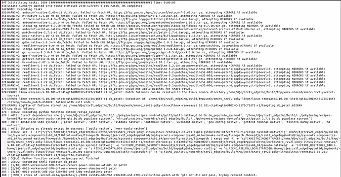

Thanks for this follow up. A bit hard to send you the data you are asking for when I can’t attach a simple text file to this query. Here are three screenshots that capture the source material I am using and the build output errors.
RZ-VL-Build-Source-Files-27-1-26
Note the R11-drpai-sp.zip file is version 0751 as suggested by Renesas. Version 0750 of this file also saw the same build errors.
Please let me know if this helps you understand what needs to be fixed.
