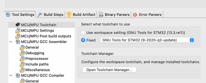

So, I fixed the issue. My procedure and coding was correct, but the miss-classification was due to the GNU Toolchain. The default was set to STM32 13.3. rel1 …naturally I had it iset to this. Why would it not be?
Anyway…I switched it to GNU Tools for STM32 (9-2020-q2-update) and hey presto …the classification started working. I’m guessing the ‘math’ works the same way as when the online example was created.
Anyway, this rings alarm bells because how do we kn ow which Toolchain to use, for whichever model/code created using the online tools?!
