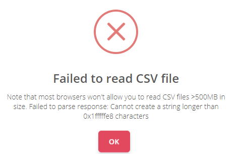

Problem processing parquet files
both uploading this 99MB big parquet file from a folder or from the csv/parquet wizard results in an error . … is it the fact that has been exported using compression?

Hello @dberardo-com thanks for reporting!
Did you try to generate smaller CSVs? (e.g. 30-50MBs?)
Try it and in the meantime i’m going to ask internally why you see this error!
thanks for the reply.
well my point is … the file is a parquet file, not a csv
either ways, i havent tried with a smaller one
@dberardo-com thanks for the headsup!
Could you try re-exporting the file with lower compression, upload and test it again?
