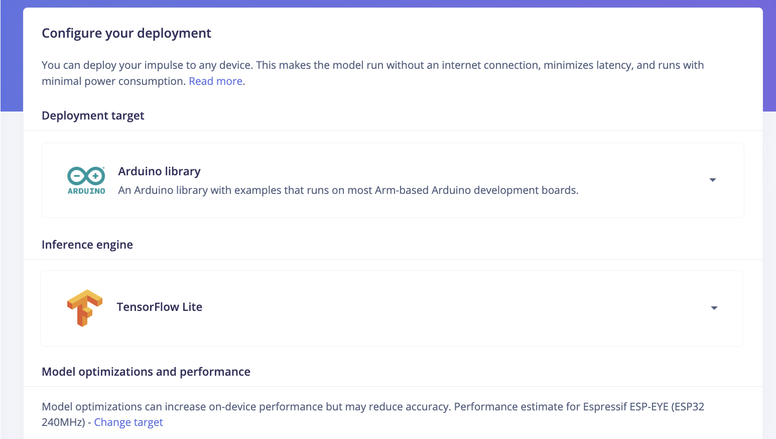

Hello @danielmichnk
Could you please share how did you configure the device?
let me share my step-by-step here that i made some months ago (hope is still valid)!
Keep me posted!
