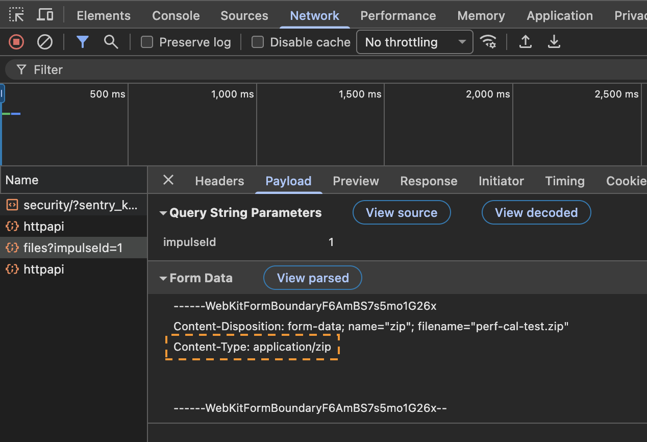

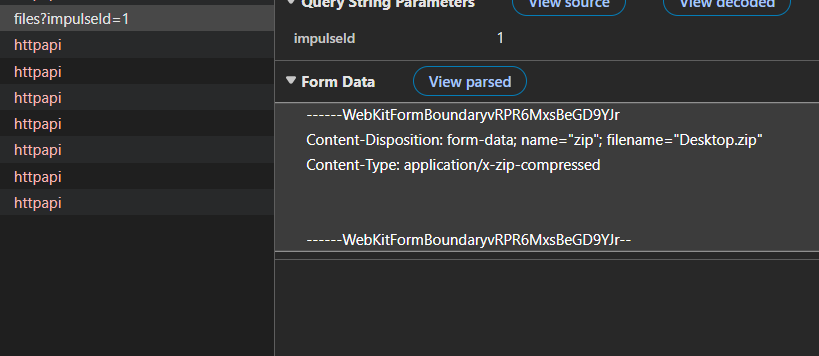

Steps to Reproduce:
Go to Perf. calibration → Options
Upload your own in a zip file (.wav + audacity txt file)
Expected Results:
.zip file uploads successfully.
Actual Results:

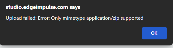

I get error: Upload failed: Error: Only mimetype application/zip supported
Same with all projects, and with any .zip file I have tried.
