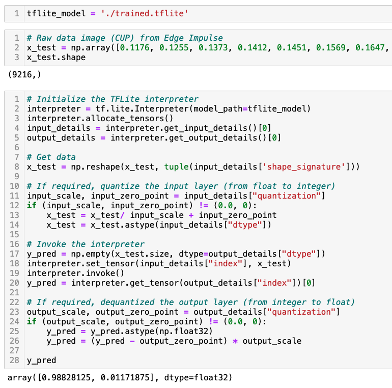

Thanks @jenny. I also deplyod the model usning a RaspberryPi and the problem seems to be restricted to TensorFlow Lite (int8 quantized). The float32 version is OK.

I’ve run your int8 quantized model on my Mac and the output was correct. So it is really OpenMV related. They’ve recently updated to the latest Tensorflow lib, this could solve the issue. Let me know if you’re able to upload your OpenMV cam. Otherwise I can send you a firmware binary.
