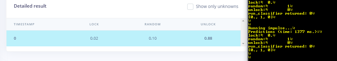

Classification gives very different results when running live classification in edge impulse versus on the STM32. I generate the Cube-MX pack as in the instructions provided in the cube-mx cmsis pack deployment documentation.
I tried both the regular and continuous classification function, and both the float32 and int8 optimization. In all cases the classification gives a different result compared to the live classification. The particular example here is with float32 and continous classification.
Live classification left, stm32 result on the right
The impulse consists of an MFE processing block and a 1D conv classifier. The processed features are already different on device, so the problem seems to be MFE related.

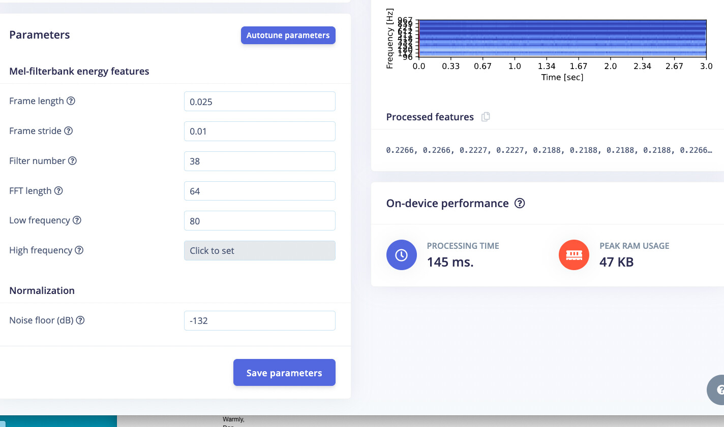

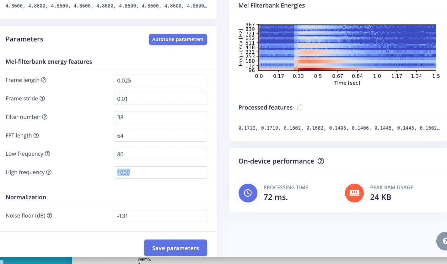

Checking out the latest project now, can you try setting the high frequency to 1000hz, it seems to be left blank. Not sure if this is something we do intentionally, will check with the DSP team.
Then see how on device performs compared to studio? If there are similar results we can file a bug with the DSP team. I’m trying to test here too but with a different device.

Thanks for having a look at it. For me, the high frequency was already at 1000Hz. To be sure I regenerated the CMSIS pack and tried again but the results are still wrong.
