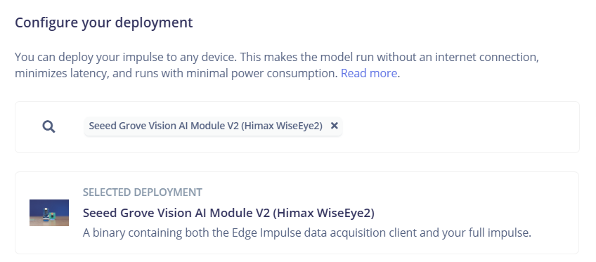

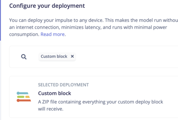

This is how we initially exported the project. The custom block you see as our current selected deployment was just us looking for possible solutions for the post processing to appear. Because another model deployment method for this board is through the SenseCraft website by Seeed Studio where we can upload the .tflite file to it and see results. And the custom block deployment have that model file. However the post processing results are still not able to show.
For the model_variables.h, the supported binary deployment (that one above) does not have that folder and files. These are the files from the build.

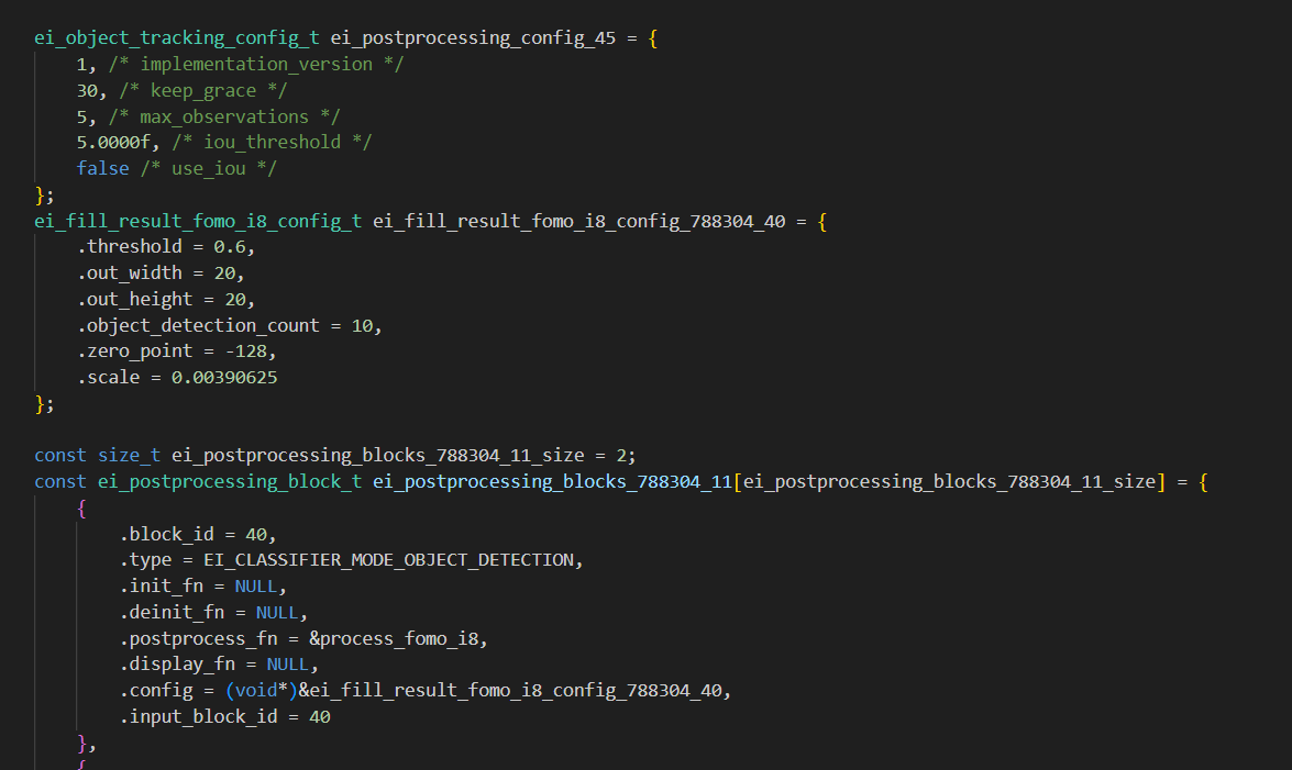

Since I also have the custom block deployment build, I checked for:
const ei_object_tracking_config_t ei_posprocessing_config_9 = { 1, /* implementation_version */ 5, /* keep_grace */ 5, /* max_observations */ 0.5000f, /* iou_threshold */ true /* use_iou */ };
And yes, this exist in the files.
However, our plan is to use the supported binary deployment for the board. We hope there is a way for the post processing block to work with it.

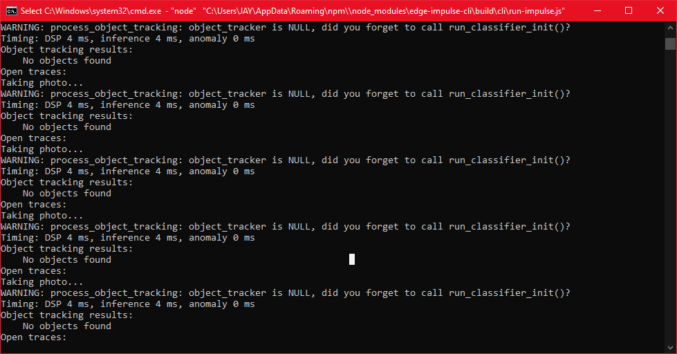

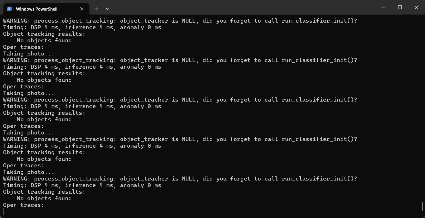

Hi, we updated the firmware and tried to redeploy the model. This is the results we are getting.
Update:

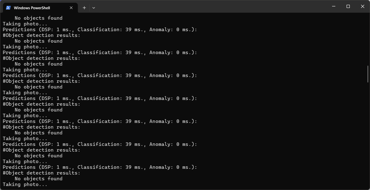

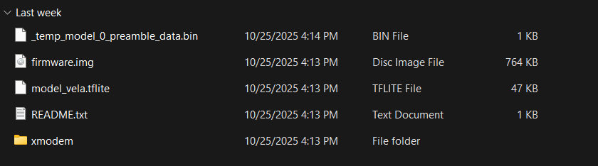

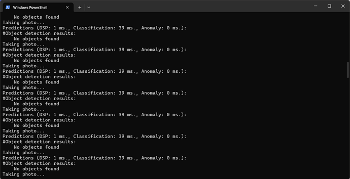

When pasting the vela model file from the supported binary build for the board to the pre compiled firmware from Seeed Grove Vision AI Module V2 (WiseEye2) - Edge Impulse Documentation, then following the readme instructions, these are the results:
The warning is gone, but it seems like the model is not working because it cannot recognize anything. This is also the case when edge-impulse-run-impulse --debug is ran. It only shows the live camera feed but does not recognize objects.
When uploading the model solely from the supported binary build, this is the output:
The result is just like from the previous reply. By the way, this is the latest build from the project’s deployment. The binary was built yesterday, Nov 1, 2025.

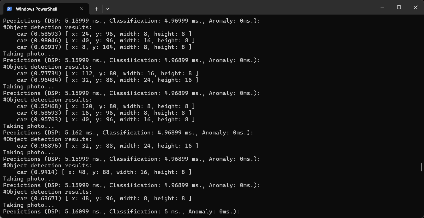

Builds from an earlier date (before firmware updates) show results. For example, this is the output when deploying a build of the project from October 22, 2025:
It detects objects, however no object tracking. Just like the initial problem of this thread.
