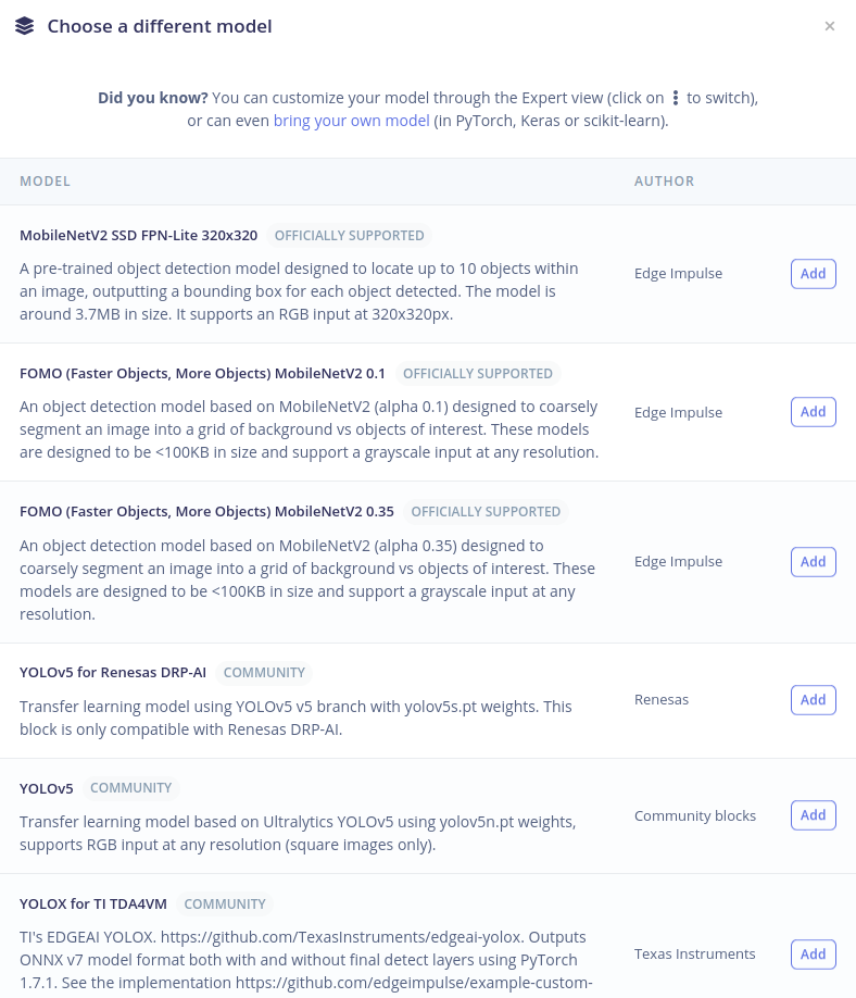

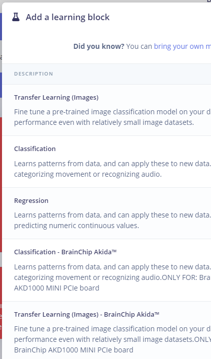

Where do you see YOLOv5? When I try to add a Learning Block I do not see YOLOv5.

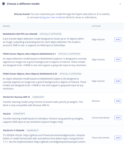

I see:
Hello @Max_Chen,
The Yolov5 version (from Ultralytics) that we provide as a community learning block is using the yolov5n weights and has been pre-trained with RGB images only.
You can add your own custom learning block, see Custom learning blocks - Edge Impulse Documentation.
Feel free to share your custom learning block with the community too, Iād be happy to test it and reference it!
