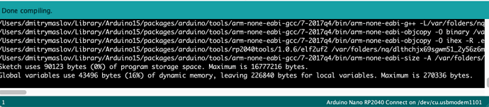

The best way you can check how much memory do these parts of the code (SDK + application) occupy is to subtract the model size from the final binary size (you can see it at the end of compilation process in Arduino IDE if you enabled verbose output for compilation).
