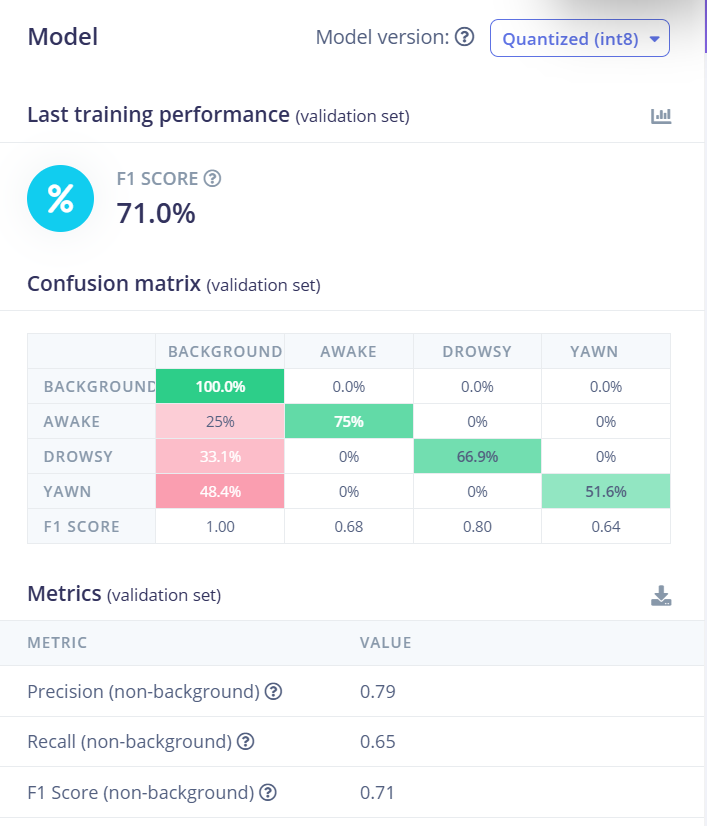

I am using FOMO (Faster Objects, More Objects) with MobileNetV2 0.35 for object detection in a Driver Monitoring System project. My goal is to export the trained model as TensorFlow Lite and deploy it on an NXP i.MX RT1176 EVK.
The model finishes training successfully and reports approximately 70% accuracy, but when I test it using Launch in Browser, the detections are not reliable. The model often fails to detect the expected classes or produces inconsistent results.
I would like to understand what is the issue that causing this outcome.

The model should reliably detect the Awake, Drowsy, Yawn and more lables classes during Live Classification and provide similar performance to the reported training metrics.
While I was testing it always shows the Drowsy even though the eyes are open and yawning is detected sometimes only.

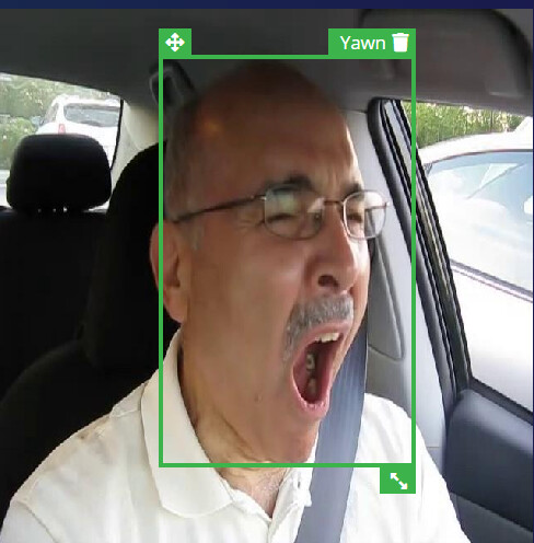

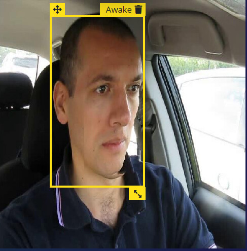

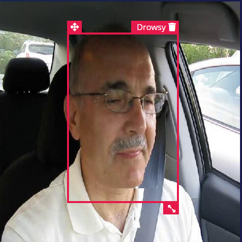

I used a dataset downloaded from Roboflow that contains three classes: yawn, drowsy, and awake. I trained the model using FOMO with MobileNetV2 0.35.
For testing I will run the model in the browser where I will use myself.
Questions:
  • All the my datasets will be like the images I have attached below where the boxes covering whole face. Is this correct way ? or do I need to cover only the mouth/eye ?

After discussin internally, we don’t think FOMO is the right architecture for your use case/dataset.
Thanks for sharing your project, it made it easier to understand the use case !
Our FOMO architecture is best at detecting objects that are about 1/8th of the total image.
In your project, I see most of your “objects” take a large portion of the full image.
Also, FOMO is training on centroids, see the docs :point_down:
