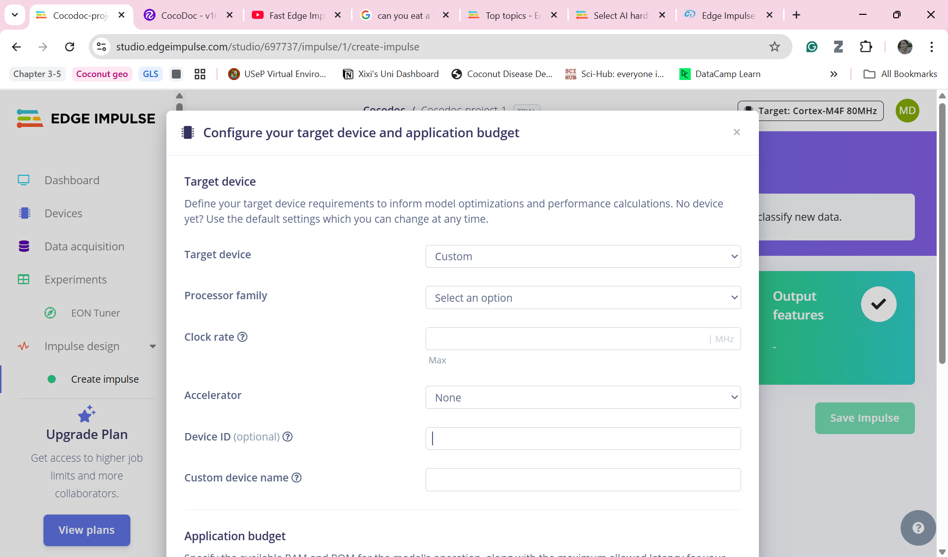

Can someone help me fill up this? I’m a newbie and I want to train a model to deploy it on a mobile application I am making. I will be deployed on Redmi Note 10 Pro phone with these following specifications:
Ram: 8 gb
Rom: 128 GB
Processor: Snapdragon 732G Mobile platform Octacore Max 2.3 GHz
Thank you! Hoping for your kind understanding.

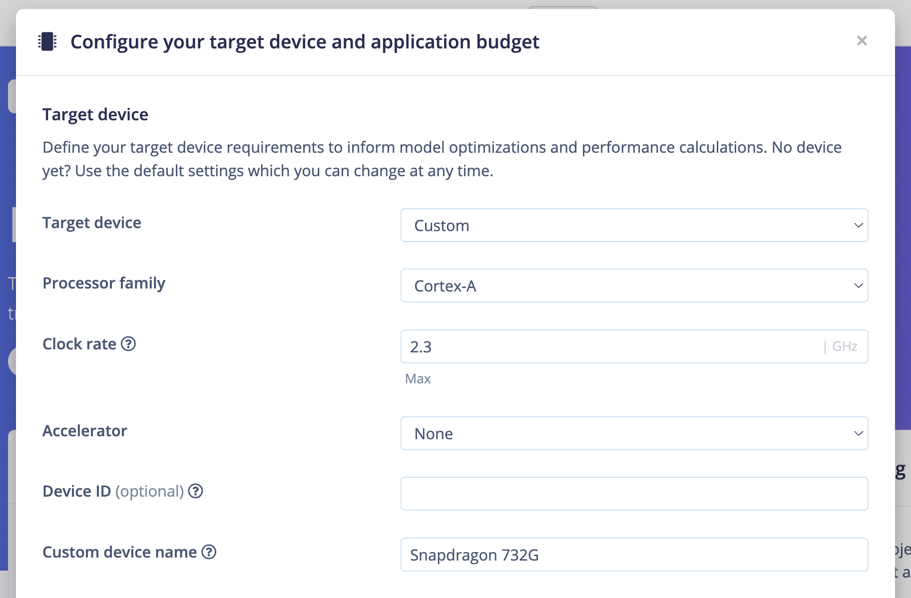

Hello @CabbageXixi,
The Snapdragon 732G is a mid-range ARM-based SoC.
The octa-core CPU has 2 Kryo 470 Gold (Cortex-A76) cores at 2.3 GHz and 6 Kryo 470 Silver (Cortex-A55) cores at 1.8 GHz.
As we don’t provide yet hardware acceleration on Android deployment, I’d suggest you use the following values:
In parallel, I’ll check with the team how we could improve this target configuration with more Snapdragon/Dragonwing SoC.
