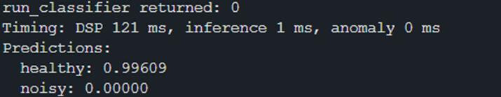

I’m experiencing an issue with my Edge Impulse project (ID: 597788).
I exported the project and imported it into Mbed Studio following the official documentation. When testing the model on a NUCLEO-F401RE board, we used raw features from signals that were correctly classified online. However, on the device, the classification results are different and appear to be stuck—it’s always printing the same class.
As a test, we input a vector of all zeros, and only in that case did the classification change to “noise.” I’ve attached a photo showing the terminal output and also included the main.cpp file used for inference.
Could you help me understand what might be causing this discrepancy? How can I fix it?
Thank you in advance for your support.

Thanks for reporting this issue let me check with the dev with experience to comment on this one:
@ei_francesco did we see this one previously?
Hi @monicatnx
I don’t have much experience with mbed studio, can you share your firmware ?
Which GCC version are you using ?
My understating is that you are testing just static features, correct ?
For the Nucleo board we have this skeleton project that you can start to use
And is returning the expected results.
