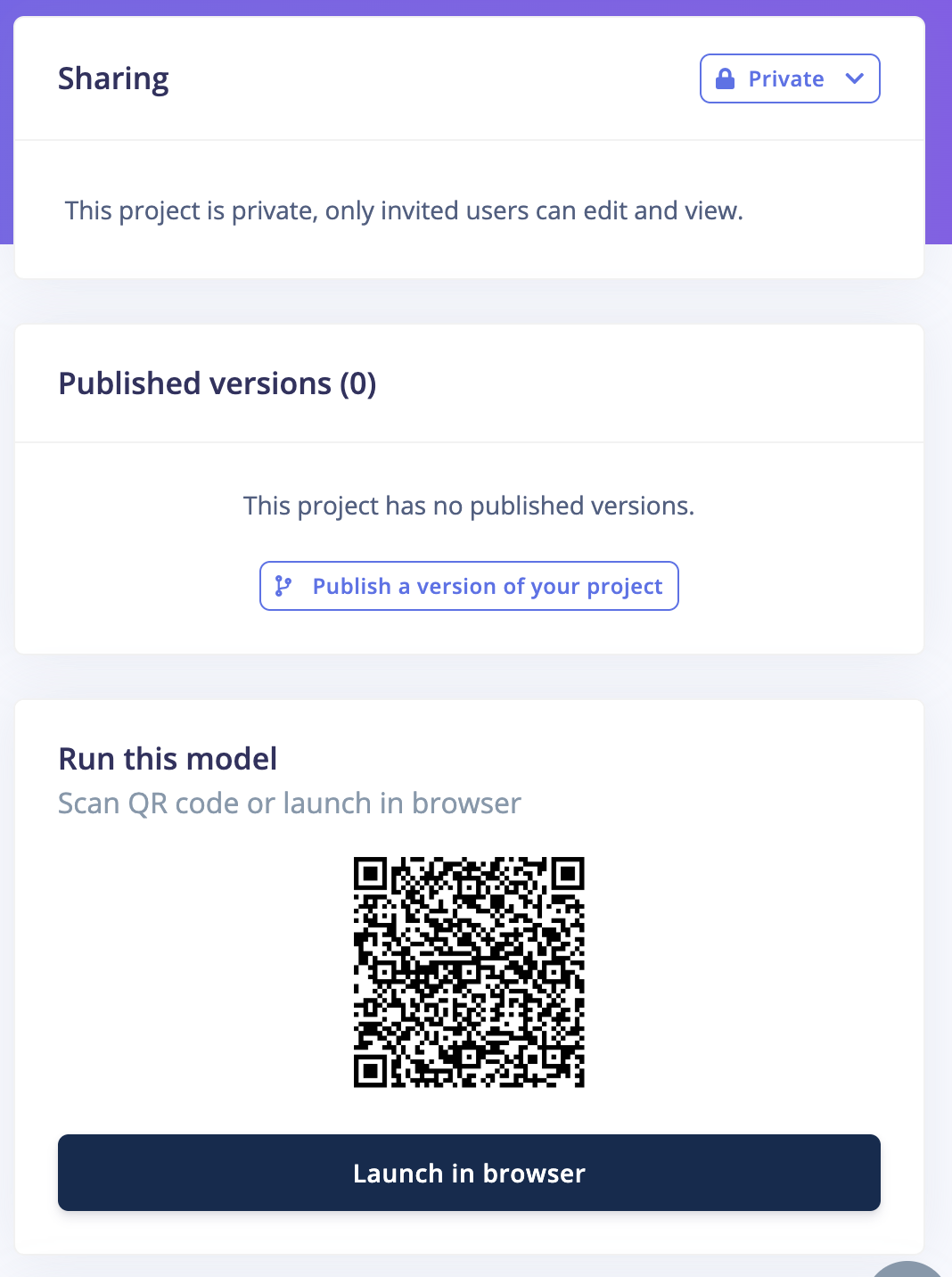

Perhaps you want to simply use your phone or computer for initial data collection and testing? FOMO-AD is fully supported by WebAsembly, meaning you can run the model in your browser.
Then when you have the suitable model, the requirements for hardware will be clear.

Ok, I’ll try developing the model with browser support.
I’ll get back to you as soon as the model is ready.
