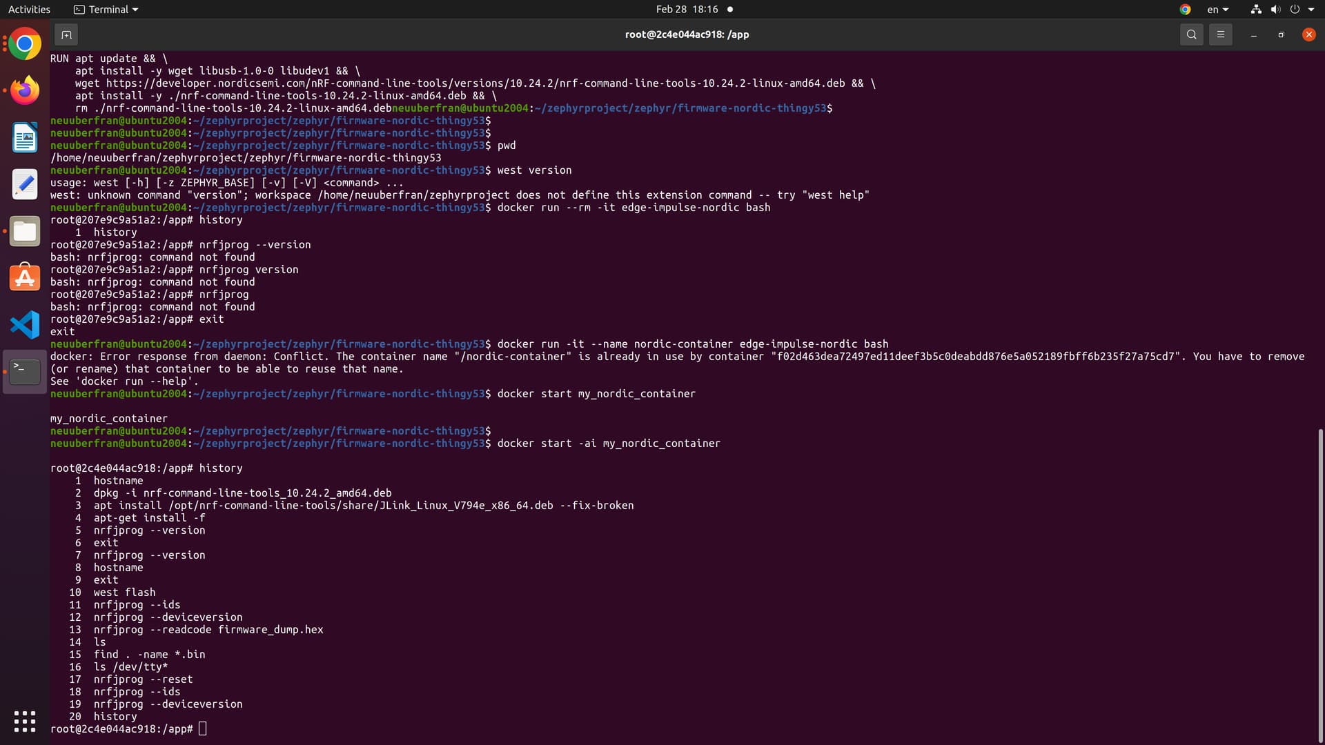

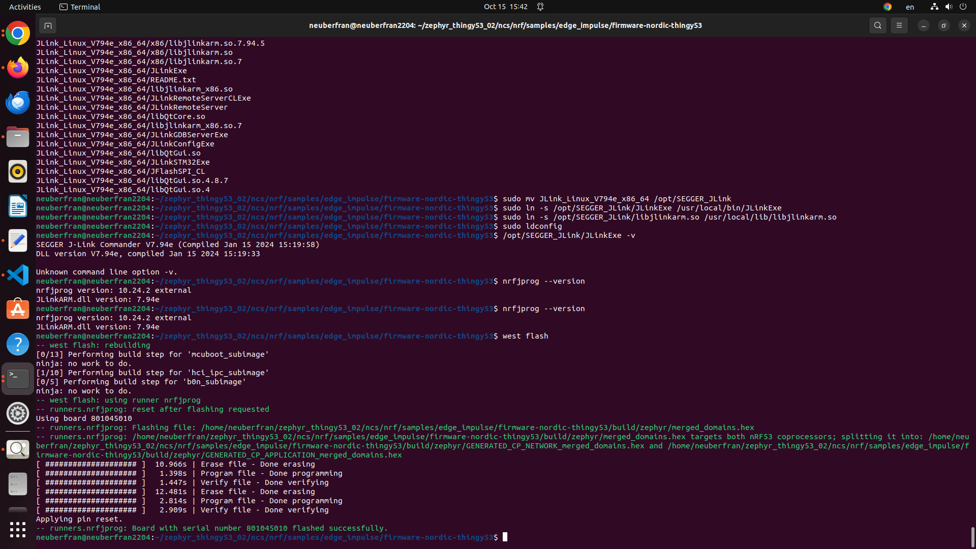

Some explanations are necessary here:
  1. I already did the famous blink led on thingy53 last week here on ubuntu and zephyr 4.1.99 (ncs 3.1.0)
  2. I’ve also used the edge-impulse app on this thingy53 successfully (registered on the app/Android phone, collected data, etc…) but on ncs 2.4.0 (I’m not sure) and the role was big because, as shown in the screen below, I had to use docker (the edge-impulse tutorial explains better) etc…
I would like you to clone the code below and try to build it either on Windows or Ubuntu 22.04 or 24.04 (using zephyr upstream and ncs 3.1.0) and show me if it works and how you resolved the errors:
Note: below is the photo I referred to:
