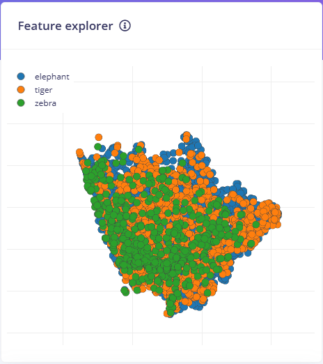

Thi issue that I am encountering is I am trying to train an object detection model with animals. While doing the labeling and tuining, I found out that the platform is unable to segregate between 2 animals and in “Image” section, ‘feature explorer’ I see a compeletly overlaping issue. So I added a third animal to see if anything changes, but no, still the same. My feature explorer looks kind of all messed up, have a look below. I am not understanding why this is happening.
For one instance I can understand zebra and tiger can be a misleading animals due to the black straps they have, but elephant no chance, it doesn’t have a single common characteristic as the remaining 2 animals.
Please someone guide me on this.

Just want edge impulse to make the segregation of all animals properly.
Not segregating the animals in proper manner, which is leading to improper detection.

Hi @InfiAI
The issue is that you have a very imbalanced dataset, also the images are not the same in lighting and distance.
Start with a smaller dataset that is balanced and similar lighting and distance then build upwards.
Hi @Eoin,
Thankyou for the guidance, I also tried with samller dataset but its not working. I am not getting why? As the object in the image are nowhere similer to each other. And the reason of selecting a little diverse dataset is so that the inference must be able to detect in any condition, day, night, etc. I also made the dataset a bit balanced this time, but still the same.
Let me know what else can be done. I will again try it with only 2 objects.
