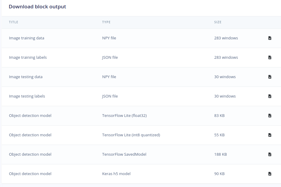

Once you’ve trained your model you’ll be able to download the raw tflite files from the project Dashboard.
You can edit these are you need to, and then reupload them bring-your-own-model

One more query, is it possible to run the model.h5 and tflite file without edgeimpulse package ?

Hello @naveen_17,
Yes it’s possible but you might need to implement any pre-processing step you used on your own.
One benefit of using the Edge Impulse export formats are the hardware optimization we leverage.
You can also use the EON compiler to save resources. See https://docs.edgeimpulse.com/docs/deployment/eon-compiler
