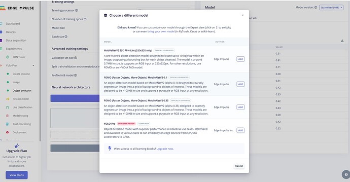

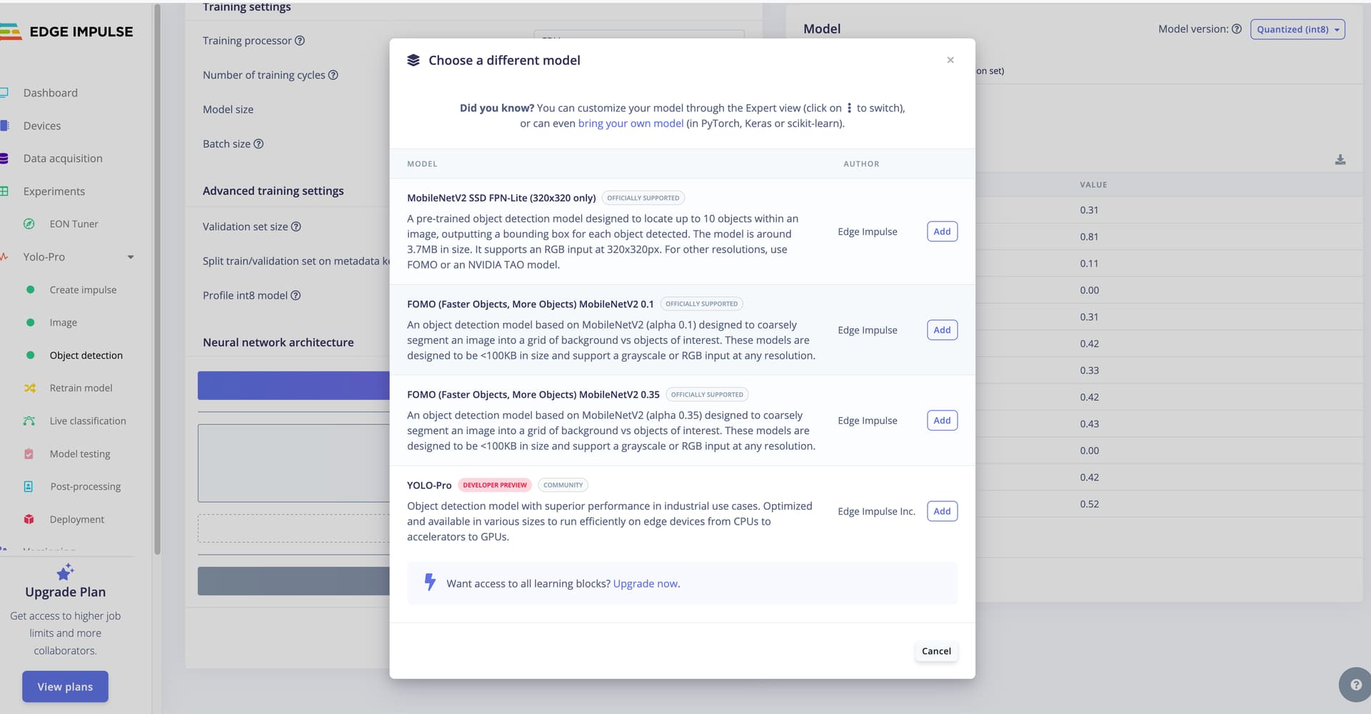

Hi, @bagelsketches !
Good timing - we have just released the developer preview of our own object detection model, YOLO-Pro. MobileNet SSD is rather old and inefficient architecture, which we intent to eventually replace with YOLO-Pro.
You can follow the guide here
to try it out.
In my regular (non-employee) user account I can see I can choose YOLO-Pro already, should be the same for you!
